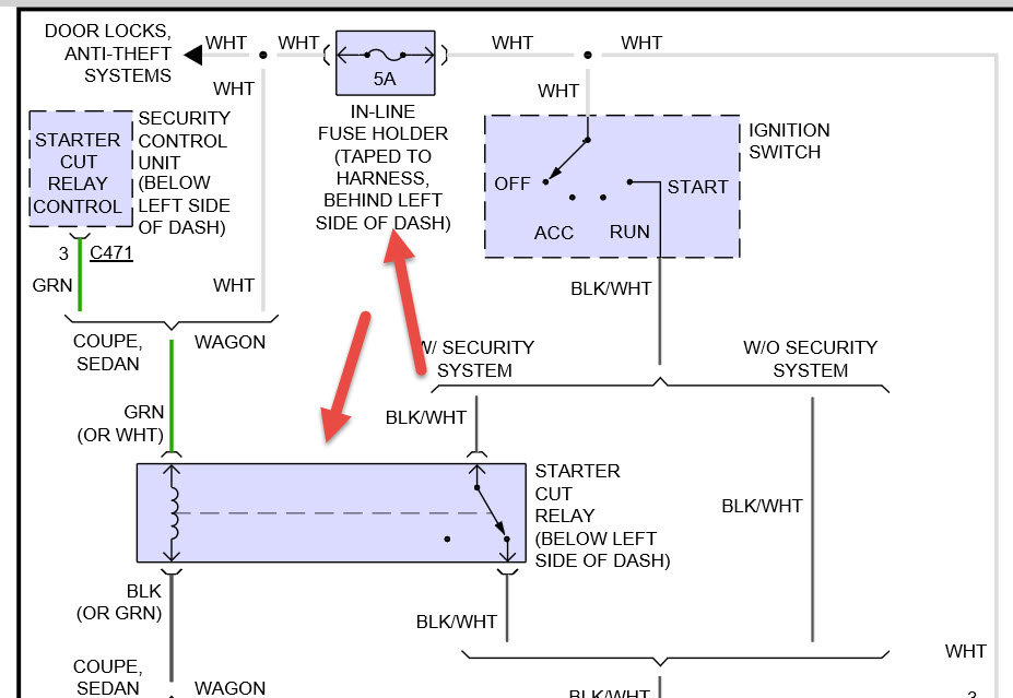

My car started having trouble starting for about a week, as though the battery was low, then just would not start. Took the battery to Autozone to have it tested and they said it was fine. When I try and start the car it does not turn over and there is no clicking sound. I made sure that the connections on the battery were really on there, but still nothing. Also, the alternator was replaced about a year ago. Could it be the starter or is there something else that may be the problem?

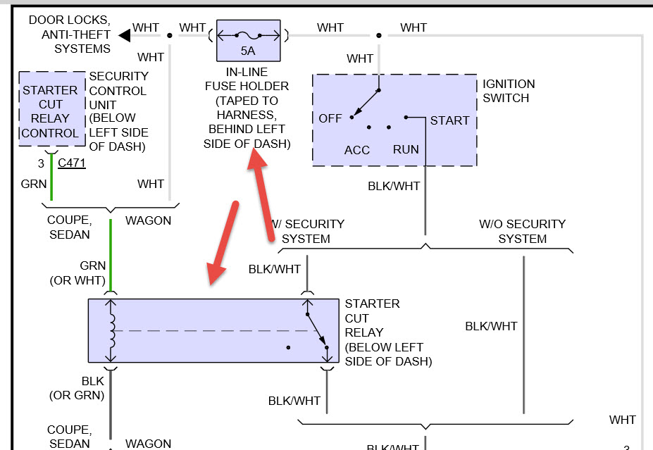

Have someone tap the body of starter with a hammer while trying to start hit it hard if you can, if it starts the starter is bad. also check fuse 15 & 19 under hood as well as ones in pic. If car has security try resetting it look online for your car on how to do it.
This guide can help us fix it
Check out the diagrams (Below). Please let us know what you find. We are interested to see what it is.
