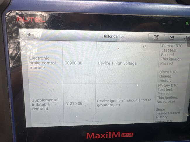

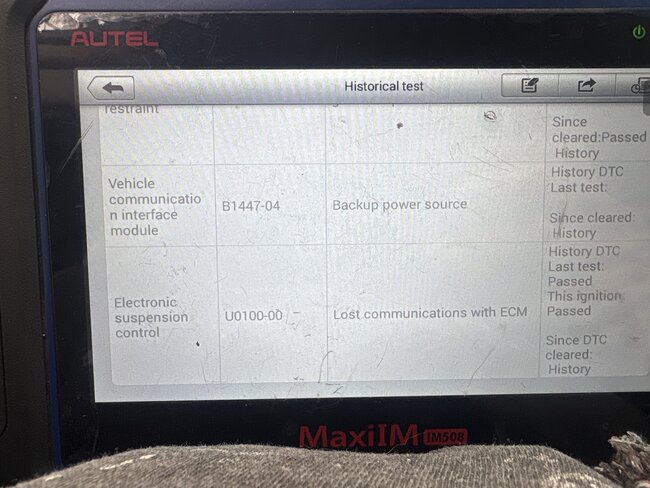

The battery is new. All of this started when I changed the intake gaskets. After I put it all back together it started but ran rough. All of the fuel had leaked out, so I changed the injector o rings as well because they were all melted from the car overheating. When I was bleeding the cooling system ran out of gas. After that fuel tank pressure sensor code popped up so I changed all of those sensors plus the fuel pump then it was crank no start and some other sensor codes popped up, so I removed and re-wrapped the wiring harness because there were bare wires then it started and drove a couple of miles but then it stalled. Started it up but then it would stall every time I turned the wheel. Then it would just stall out right after start up without turning the wheel and now it’s just no crank no start but I checked, and the wire harness is all plugged in correctly and nothing is touching. All the original codes are gone but new ones popped up. I’ll list them. Also, the ABS and traction control lights are illuminated on the dash now.
Mar 26, 2025 at 10:38 AM
ARIANADANIELLE5345
  • 402 POSTS
My Autel won’t connect to it now for some reason but these were the codes from yesterday. Also, when I try to turn the key, the power shuts off but comes right back on when I release the key from the cranking position and put it back in acc.
