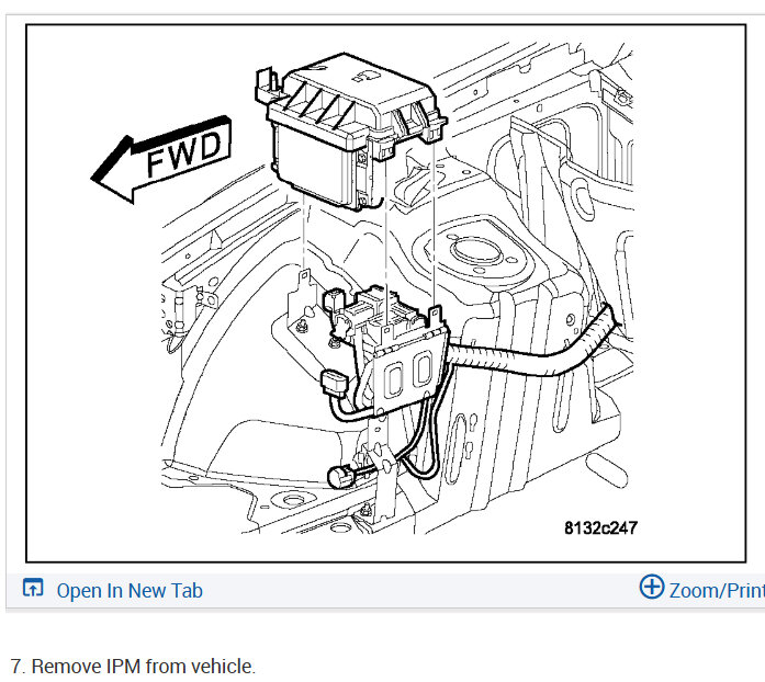

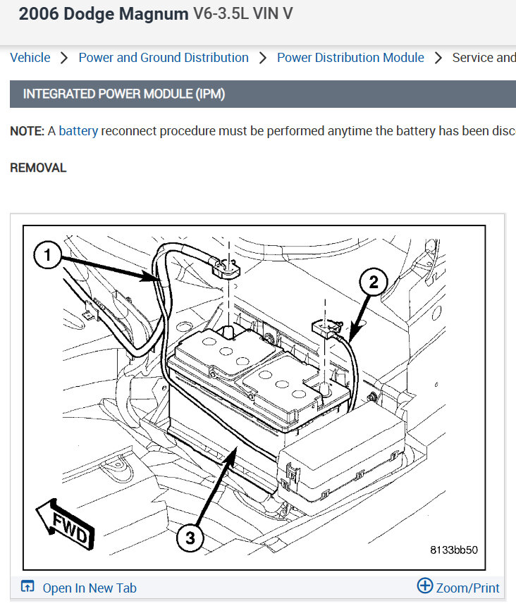

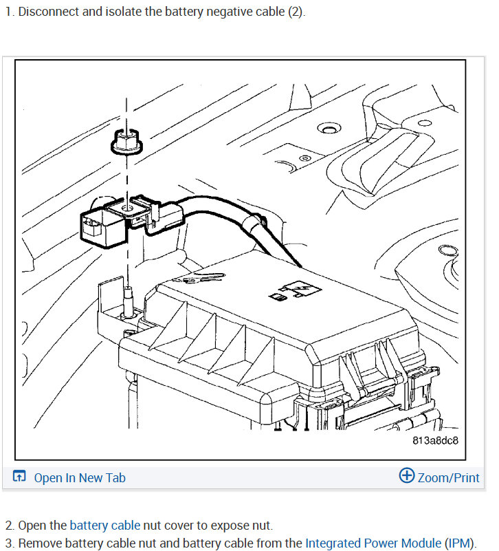

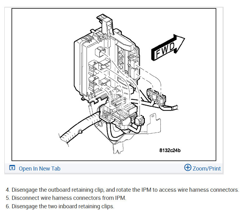

Here is how to change out the IPM which is easy because it-self learns. Check out the images (below). Please let us know what happens.
