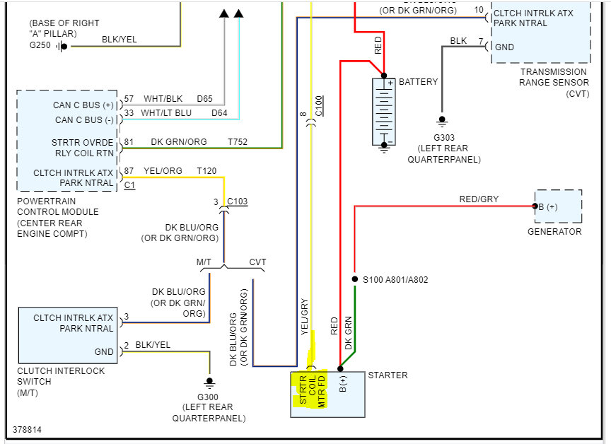

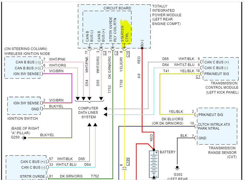

This vehicle doesn't have a traditional starter relay. In its place is a circuit board that is integral to the totally integrated power module (TIPM).
Have you tried starting it in neutral? There could be a neutral safety switch issue.
Anyway, I attached the wiring schematic for the starting circuit. I highlighted what has taken the place of the relay. What I need you to do is have a helper turn the key to the start position while you check for power at the yellow wire with a white tracer on the starter.
If you find there is no power, let me know. We will need to check for power at connector 10 pin 8 at the TIPM. I you feel comfortable, do that as well and let me know the results.
Let me know what you find.

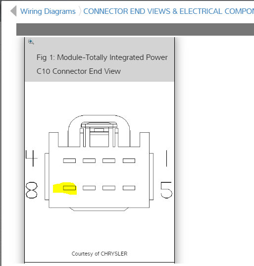

Connector 10, pin8 is located where?

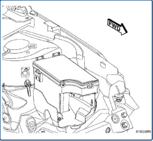

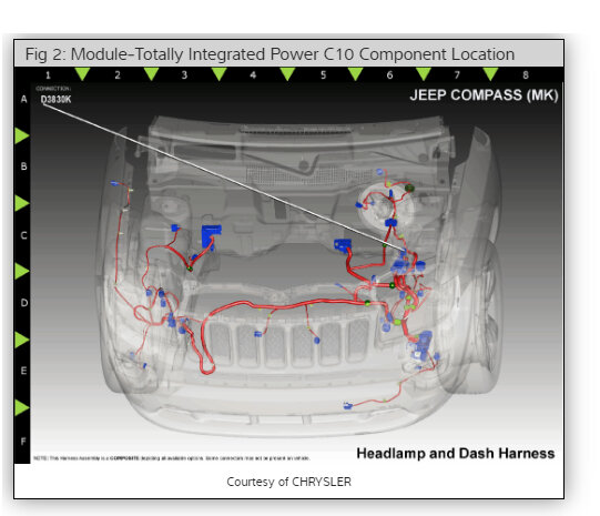

Okay, if you look at pics 1 and 3 below, it will help locate the TIPM and connectors.
At the TIPM will be several connectors. The C10 connector will be gray in color and is an 8-pin connector that only uses 5 of the connectors.
Disconnect the connector and inspect the connector pins first. Make sure they are in good condition and not damaged or corroded.
If they are in good condition, then you need to check pin 8 from the TIPM for power when the key is in the start position, so you will need a helper.
I attached pics below to help.
Take care and let me know the results.

If you have power to pin 87, the starter should engage. That is the power supply to the starter trigger wire. If you have a helper turn the key to the start position, are you getting power at the yellow with a gray tracer wire at the starter?
Also, if you have power at 87, the ignition switch is working along with other things. The only thing that can cause this to not work would be a faulty ground path to pin 86 when the key is in the start position. But, if there is power at 87, that indicates the relay has done its job, and the starter should engage. Check that yellow/gray wire.

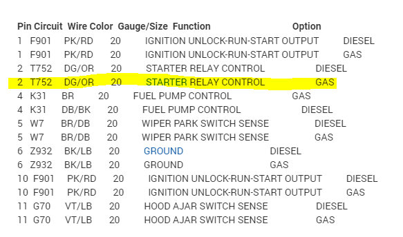

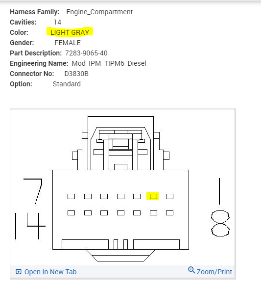

That is the problem; the ground can't handle any load. If I had to guess, the problem is at the TIPM connector. That is a theory. I suspect the ground terminal for that wire is either corroded, damaged from corrosion, or pushed in on the connector.
On the TIPM, we now need to check connector 2 pin 2 to see if the ground path is lost there as well. I attached a pic below showing the connector. It will be light gray in color and have a 14-pin connector.
