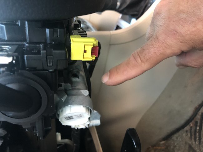

I don’t think my car has the anti-theft immobilizer option, not seeing any indication light in dash cluster. Picture is the steering lock/ignition assembly I removed and repaired to get key to turn. Battery was disconnected (+ side) while doing so. It’s not a push button type ignition, key fob only locks/unlocks doors and trunk and alarm.

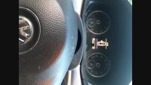

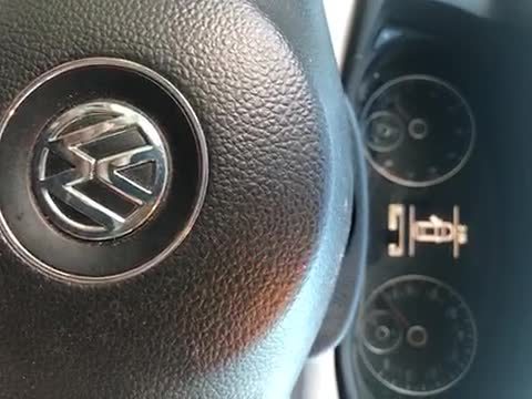

Tried the battery suggestion and the VW portion of resetting immobilizer, and the end result is the same. Car still does what’s shown in the video.

So, the engine is not cranking over. I did not hear it crank over. Also, what does the warning light say in the information center the video is blurry and I can't read it.

No, the engine does not crank over when the key turned to crank position. When the key is turned to crank position, all dash lights go out. Information center in dash says, “welcome to your Passat”, then shows picture of car with door open. (I had door open when attempting to crank.)

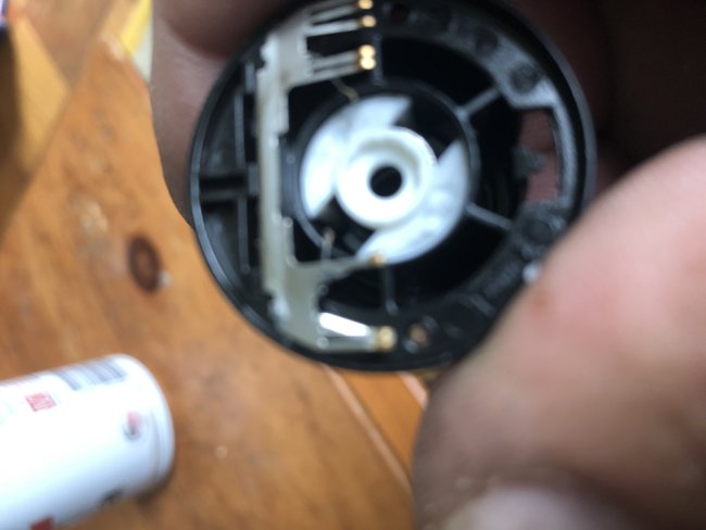

I took a shot and replaced the ignition switch, figured that’s where my problem was when I noticed the backside of the ignition switch would kind of bulge out when key turned to start position.
I reassembled everything, put the key in ignition and presto, it started.
Took the old ignition switch apart and found connectors all bent.
Thanks for the help.
