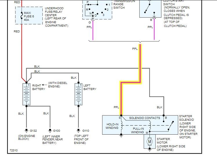

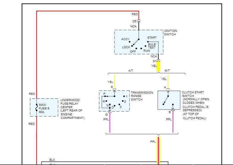

Truck won't crank. When you turn the key over dash lights come on and battery is good. It just won't crank.
Monday, March 9th, 2020 AT 1:14 PM
MECHANIC
52,796 POSTS
Good afternoon,
What is the battery voltage? You need 12.4 to 12.6 volts.
I attached a wiring diagram for you. Do you have a test light or voltmeter to do some testing?
