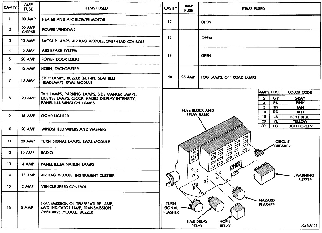

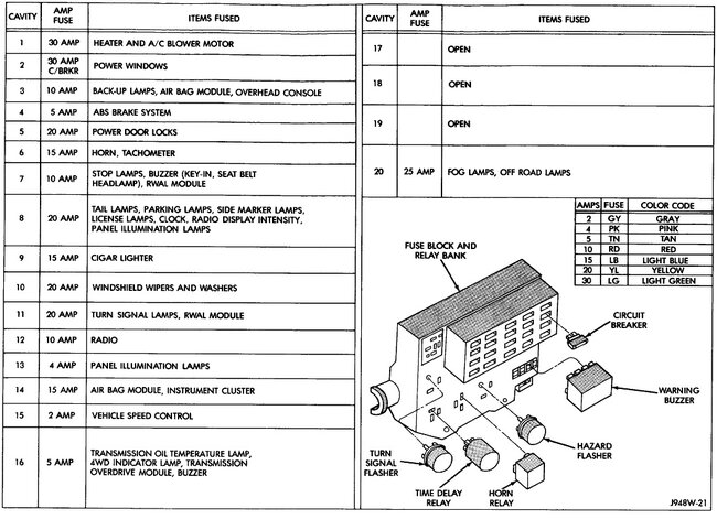

The blown fuse is the place to start, but you have to figure out which one it is, and if it's under the hood or inside. Don't worry about the yellow ABS warning light. Two different circuits feed 12 volts to that computer. When either one is lost due to a blown fuse or some other cause, the other circuit powers the warning light to tell you that system is turned off.

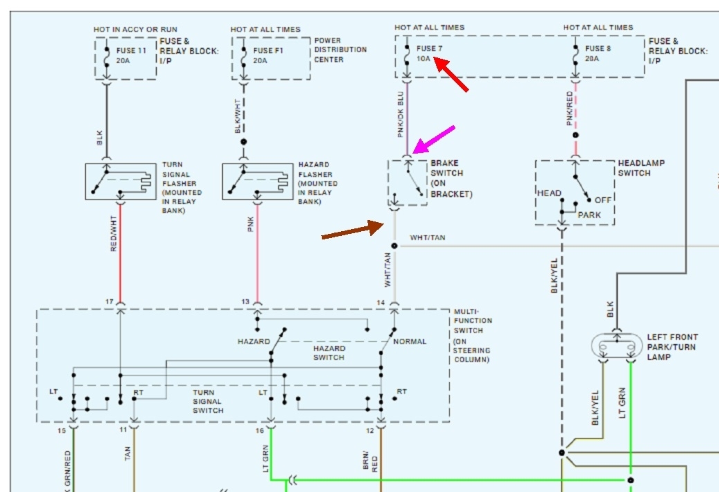

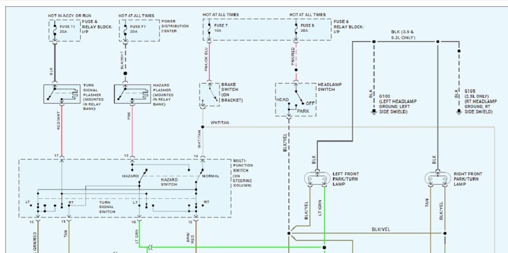

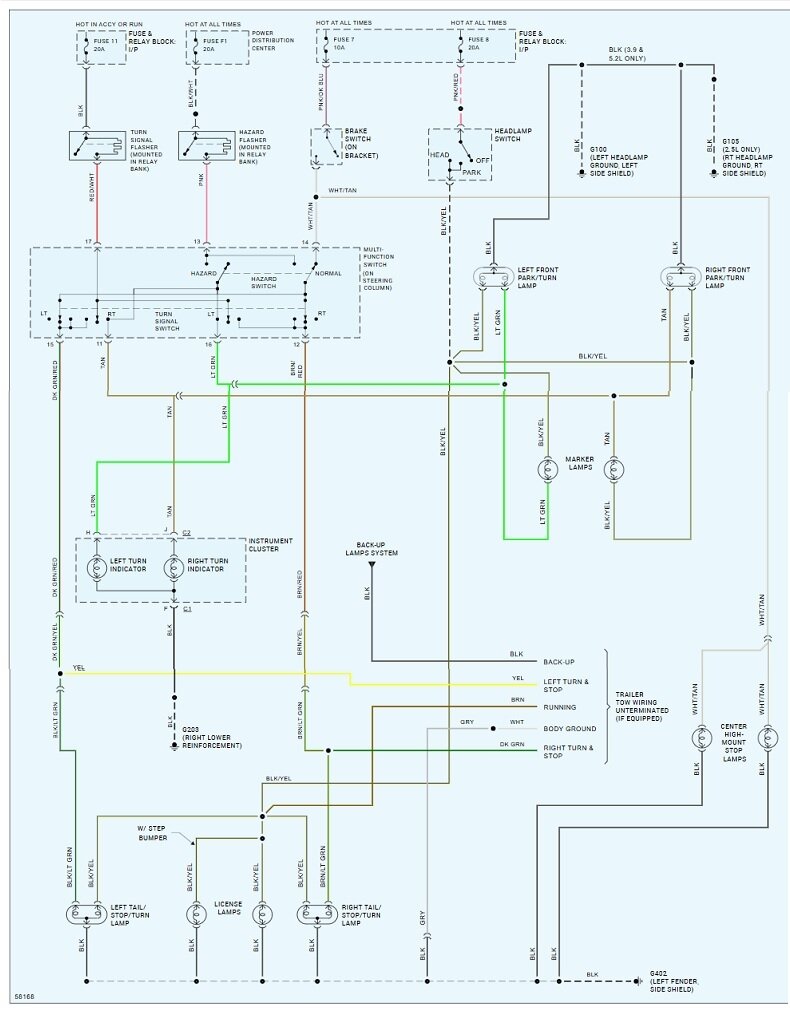

I had to go with aftermarket diagrams. Our source doesn't show the brake light switch on the original diagrams. This first one is the complete system. It can be hard to read, so the next three are the top, mid, and bottom, expanded as much as I could. The last diagram is just the top, expanded a little more.
For these tests, it is okay to use a digital voltmeter, but a simple, old-fashioned test light is a better choice for this type of problem. Go to the brake light switch and check for voltage on the white / tan wire, (brown arrow). There can be up to six wires on that switch. Voltage readings must be taken with that switch plugged in. You should find 0.0 volts at first, then 12 volts when the brake pedal is pressed. If you do, everything is okay up to that point. If there's no 12 volts showing up on that wire, check for 12 volts on the pink / dark blue wire, (pink arrow). That one must have 12 volts all the time. If it's missing, fuse 7, (red arrow), is the best suspect.

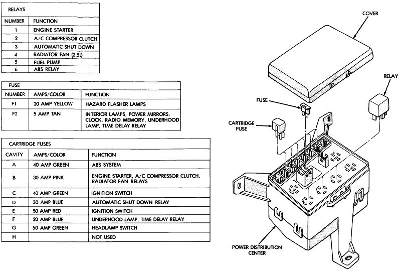

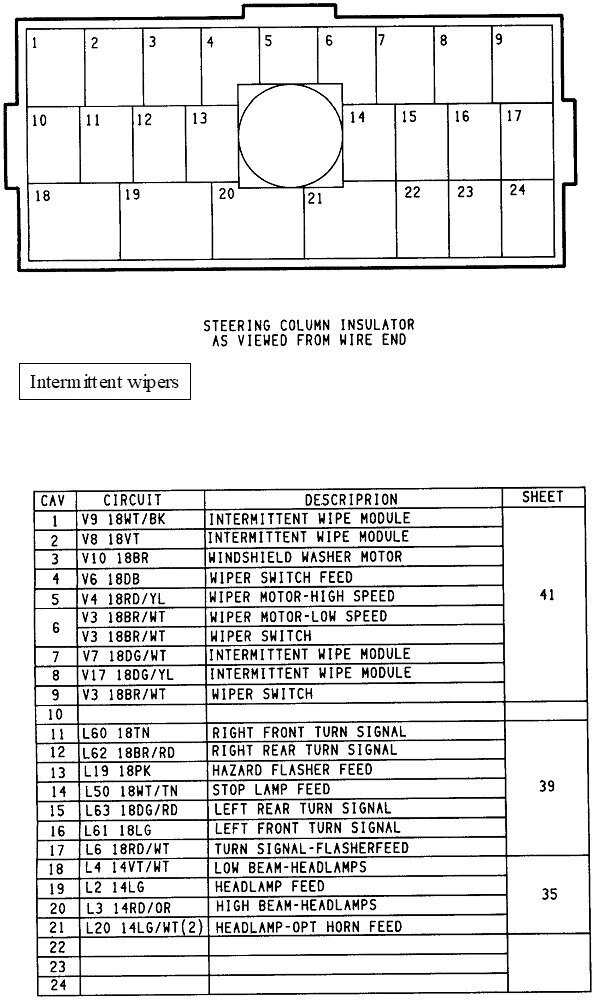

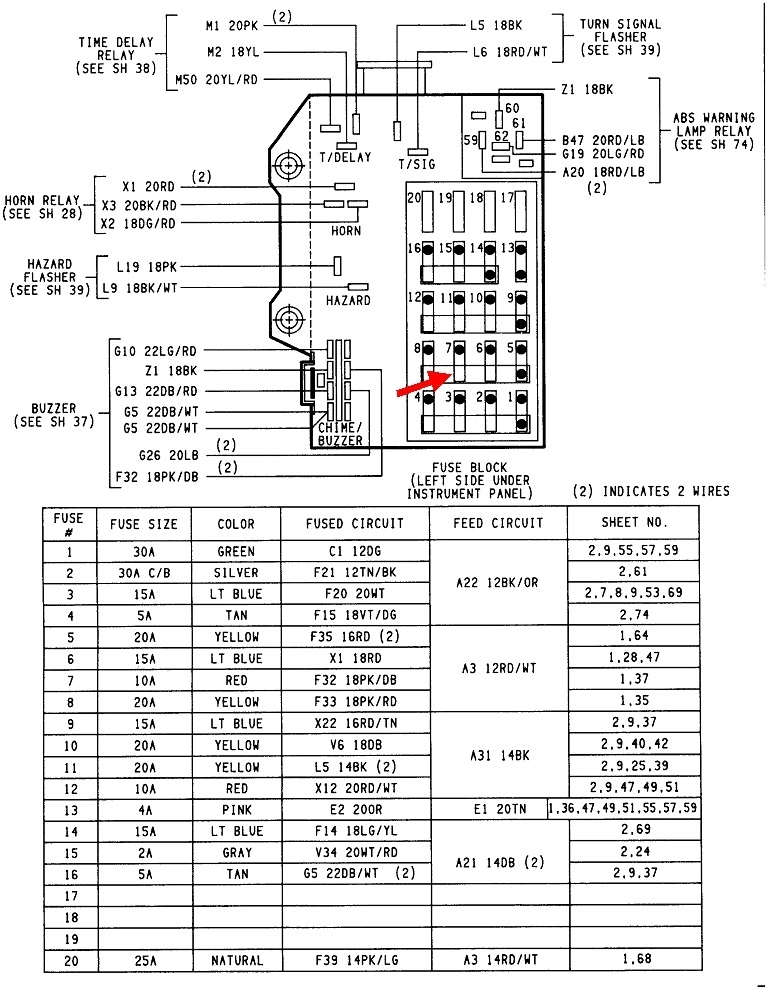

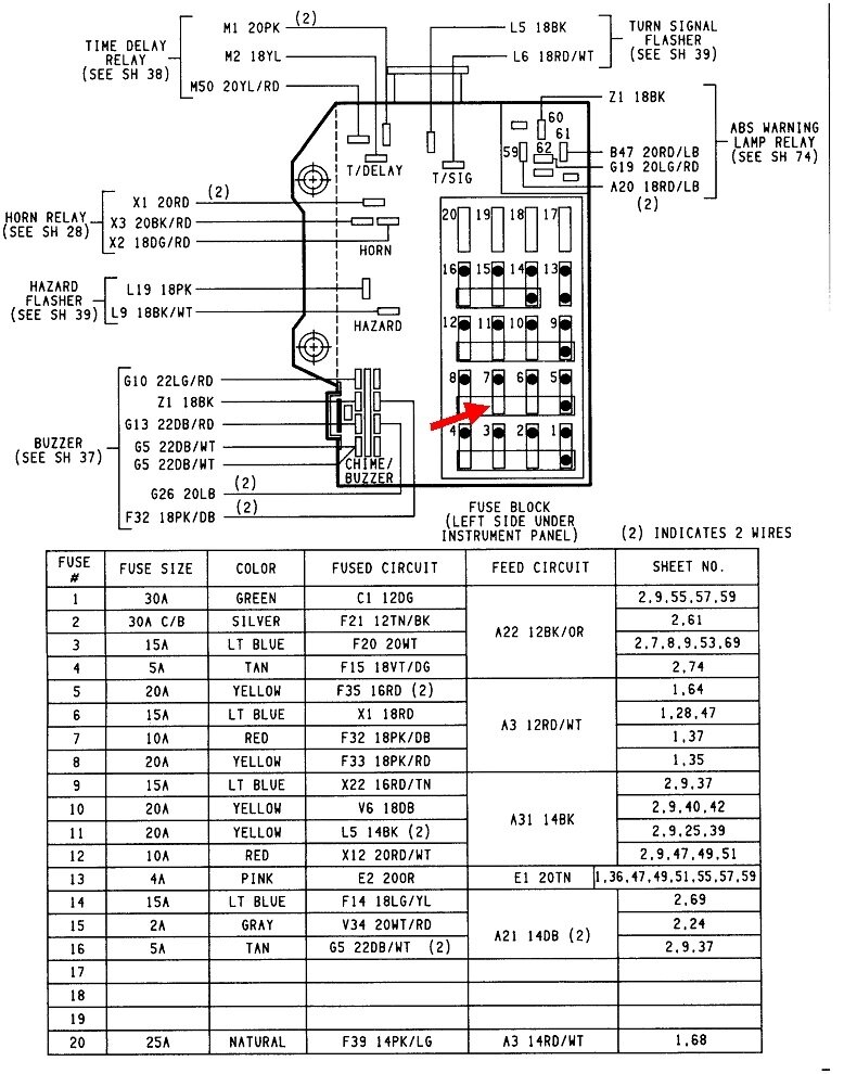

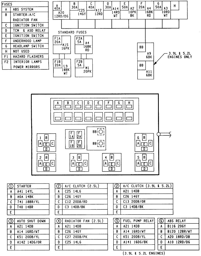

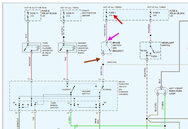

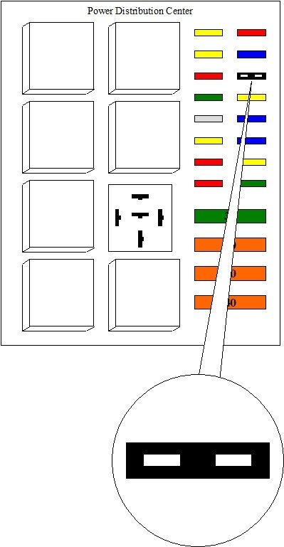

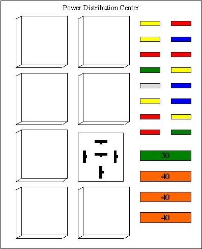

Getting back to your brake lights, to catch anyone else up, these first two drawings are for the Power Distribution Center, (PDC / under-hood fuse box). The next two are for the Junction Box, (inside fuse box). I added a red arrow pointing to fuse # 7 that powers the brake lights. Note fuse # 7 also runs the key-in buzzer, so if that buzzer works, you know the fuse is okay.

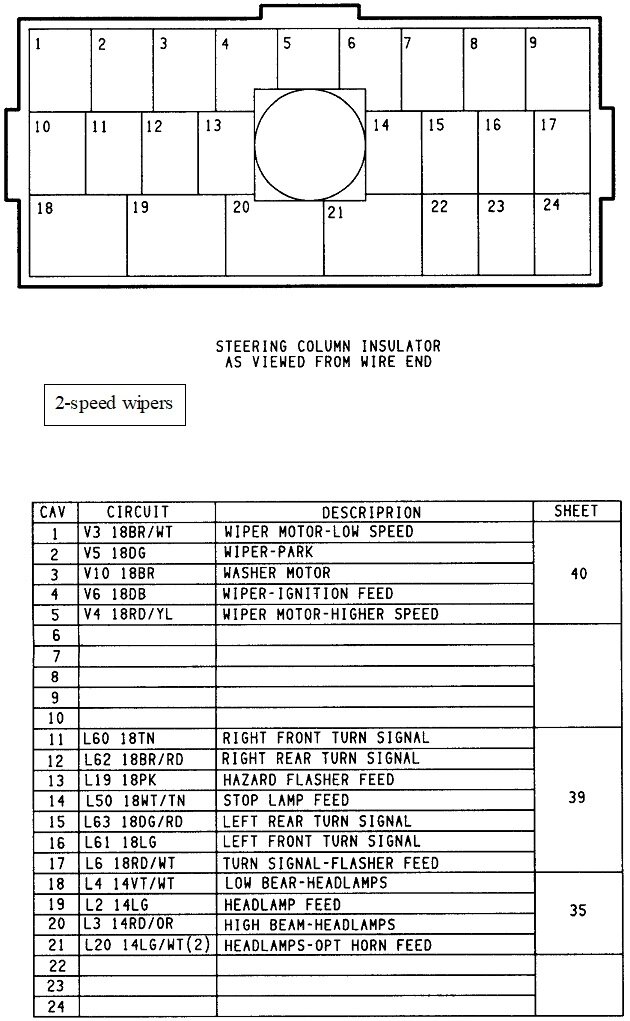

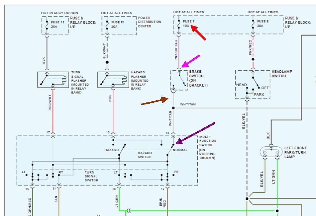

To continue on, the next step is to check for 12 volts on that white / tan wire at the multifunction switch connector. This switch design is a real lot easier to remove than the older style, but there's still some work involved. We can skip ahead in hopes the switch is okay, then back-track if necessary. The common problem with this switch is the right half of hazard switch where the white / tan wire comes in on terminal # 14 When that part develops an arced or pitted contact, current to the brake lights can't get through. A potential clue is if you hold the brake pedal down, the brake lights might flicker when "irritating" the hazard switch. That switch can also become deformed inside and short intermittently, blowing fuse # 7.
Also note 12 volts for the signals comes in on a different circuit from fuse # 11, then through the flasher, and to the signal switch on terminal # 17. Being on a different circuit, this is why the signals might work while the brake lights don't, or the other way around

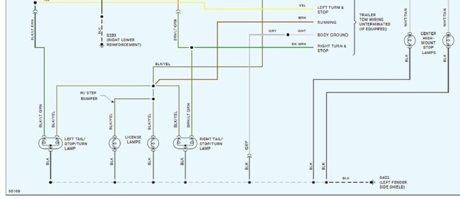

The easiest way to proceed is to go back to the tail light housings and check for 12 volts at the sockets. If you don't have a helper, use a stick from the driver's seat to the brake pedal to hold the pedal down a little. On the right side, look for 12 volts on the brown / light green wire. If it's there, that bulb should light up. If there's no 12 volts there, have a helper turn the signal switch to the left-turn position. That leaves the signal switch contact connected to the brake light switch, but it slides the contacts across each other. That can identify a defective switch contact.
Do the same for the left rear brake light. Look for 12 volts on the black / light green wire. If there's 0.0 volts, turn the signal switch to the right. If that makes the left brake light work, suspect the signal switch.
If you find 12 volts on either wire at the rear sockets, at any time, that proves the wiring is okay. If you never find 12 volts at the rear, it's then that we have to go back to the signal switch. Once removed, there's a couple of ways to approach it. If you can get a test light or voltmeter probe in there, back-probe the connector to check for voltage. Another way is to use a small jumper wire to connect the white / tan wire, (terminal 14), to one of the brake light wires, (brown / red terminal # 12 or green / red terminal # 15). That bypasses the signal switch, and one brake light will work if the rest of the circuitry is okay.

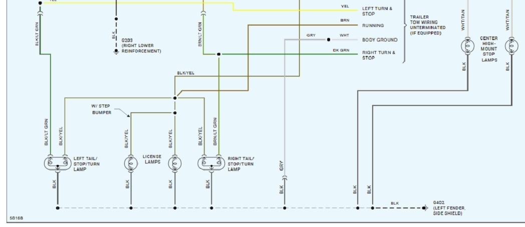

Notice too, to add confusion to this story, the two brake light wires change color at a connector. The dark green and the brown stay the same, but the colors of the tracers change from red to yellow on both wires. I mention that so you don't get excited when the wire you expect to find is different.

Gotta stop here a minute for you to re-educate me. I remember you have one brake / signal light and one taillight on one rear corner, both in one bulb, is that right? Oh; wait a minute. I think I understand. You're saying if you jump the white / tan wire to either the green /red OR to the brown / red, both the left rear and the right rear brake lights turn on. Do I have that right?
If I have that right, operation is correct, and the signal switch is the suspect. You just proved the bulbs, the wiring to them, their ground circuits, brake light switch, and fuse are all okay. The only thing you bypassed was the non-working signal switch. I added a striped arrow to this diagram to point to the bad contact on the hazard switch part of the signal switch assembly. If you were to take the switch apart, locate that contact, and solder in a jumper wire, the brake lights would be back to working, however, if you turn the hazard light switch on, those will work too, but then pressing the brake pedal would make the front signals light up too as brake lights.
The reason both rear brake lights are turning on when you jump the white / tan to just one of the rear wires is the two wires are tied together inside the signal switch. That's why just one 12-volt feed from the brake light switch sends 12 volts to both rear lights. There's two ways to prove this. One is to put that jumper in with the switch unplugged. Now you'll be sending 12 volts through the jumper wire, to just the one rear wire, and only the left or only the right bulb will turn on.
The other way to prove this is to just move the signal lever to the left or right-turn position. When you turn it to the right, for example, the brown / red wire is disconnected from the brake light switch 12 volts and gets connected to the signal flasher's 12 volts. The left rear will stay on as the jumper wire has it tied to the brake light switch, and the right rear will flash if the ignition switch is on, or it will turn off if the ignition switch is off.

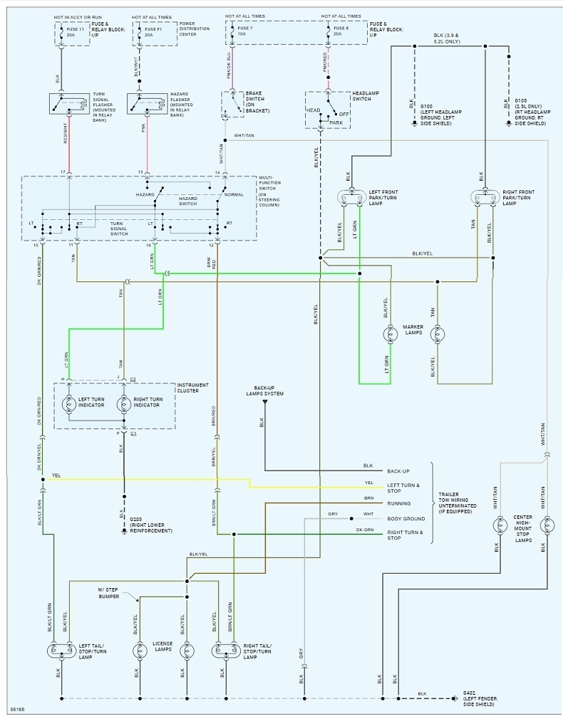

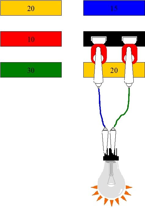

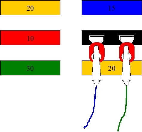

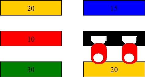

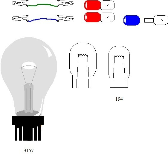

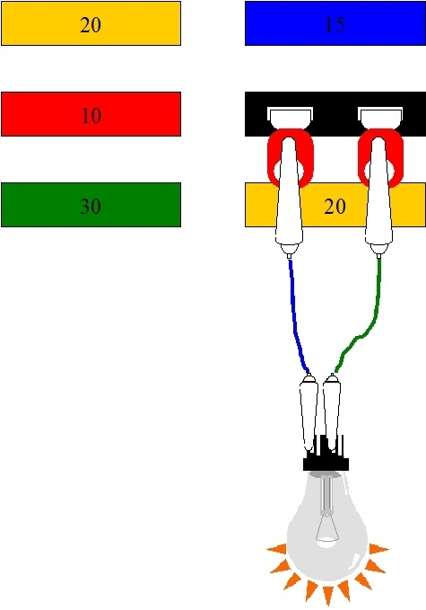

Here's the way to approach this. Some of these drawings are unnecessary but might be helpful to others.
1. Remove the blown fuse.

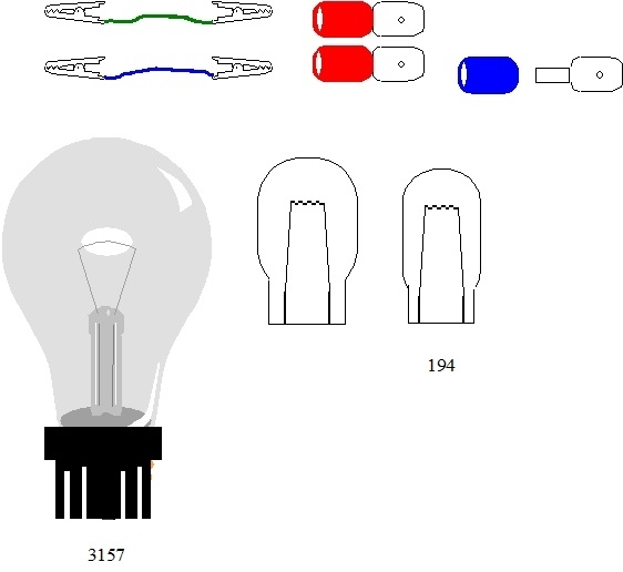

2. Plug in a pair of universal crimp-stye terminals. Don't stick anything fatter than the blade of a fuse in there as that can spread the female terminal to where it makes a poor connection later.
3. Items needed begin with a 12-volt bulb. A common 194 "peanut" bulb works well and is easy to connect jumper wires to, but it will only pass a half amp of current. Most circuits draw more than that when they're working properly, so this bulb won't be effective at showing the difference between when there's a short and when there isn't. A 3157 works better. It will pass one amp, and is just as easy to hook jumper wires to. For higher-current circuits like fan motors, you can use a common 9004 head light bulb. The high-beam filament will pass six amps; the low beam will pass five amps, and if you use the two in series, will pass roughly three amps.
The jumper wires are shown in the upper left of that third drawing. You don't have to use those, but they make the job easier and faster. You can find a pack of 10 or 12 at Harbor Freight Tools for less than five dollars.
The terminals are shown in the upper right. You buy these by the box at any hardware store, or you can cut them off an older vehicle in a salvage yard. I made a test harness by soldering a Dodge Viper rear taillight harness to a blown fuse. In this drawing, I drew one terminal with the blue insulator removed. It takes some effort, but those can be pulled or twisted off, if necessary, so the jumper can be connected.
4. The terminals have been plugged in to the fuse's socket.
5. The jumper wires are connected to the terminals.
6. The other end of the jumper wires are connected to the light bulb.
With this setup, the bulb will be off when no current is flowing. When you turn the circuit on and there is a short, the bulb will be full brightness. It will limit current to a safe value, just the same as if you had connected it directly to the battery. At full brightness it is going to get very hot, so don't allow it to lay on carpeting or against plastic panels. I would hang my Viper harness over the rear-view mirror so I could see it from any corner of the vehicle.
If the short occurs when you turn on, ... Lets say the left turn signal, but not the right one, leave it in the left-turn position and begin the diagnosis. If the short only occurs when you press the brake pedal, use the stick to hold that pedal down a little. Now, with the bulb full brightness, go around and do things until you find what makes the short go away. When it does, the bulb will dim. How much it dims depends on how much current the circuit normally draws. In this case you're powering two brake light bulbs. Because there's more bulbs than the one in the fuse holder, those two will turn on very dim when the short is gone. You may need to shade out any light and look really close to see the dim glow of the brake light filaments. The test bulb will dim too, but not as much. It will be brighter than the two brake light bulbs, but it will definitely dim enough for you to notice.
The first thing I look for is a chewed-up trailer harness. Those were fairly common on minivans because the hitch is so close to the ground and people often wrapped the harness around them. Next most common was a harness rubbed through in a car's trunk from stuff sliding around. I also had an intermittent one on a Dodge full-size van where someone removed the rear lamp housings to connect trailer harness wires, and when they put the left one back together, they caught a wire under one of the mounting screws. Pressing very lightly on that housing made the short occur, as it did over bumpy roads. I had one with a mudflap screw run through a wire harness, a GM car with a factory-installed harness run under the metal frame of the rear seat, and over time that bracket rubbed through the wires. GM is also well-known to run harnesses under the carpet, under the driver's foot area. That's a good place to find wires rubbed through and corrosion from salt and water. The weirdest one I had was insulation hardened and cracked off the wire running through the mounting arm of a passenger-side sun visor. It moved slightly during braking, and blew the interior lights fuse.
If you see the test bulb, get bright and it flickers in brightness, the best suspect is a wire rubbed through and is laying on a bare spot on sheet metal. If the short occurs when doing a "brake stand" with the engine running, look for a harness that fell down onto hot exhaust parts, or is laying on the sharp edge of a metal bracket. When the test bulb is bright and solid, the better suspect is a shorted component, including a computer module. Things like that don't change with bumpy roads or slamming doors.
Speaking of doors, the harnesses between the hinges is another dandy place to find frayed wires that break or touch each other. The short often comes and goes by opening and closing a door. Use a rubber hammer around the vehicle to make intermittent shorts occur. Look for inline connectors that can be unplugged. If doing so makes the short go away, you know everything up to that plug is okay, and the short has to be after that plug.
See how far this gets you, then let me know what you find.
