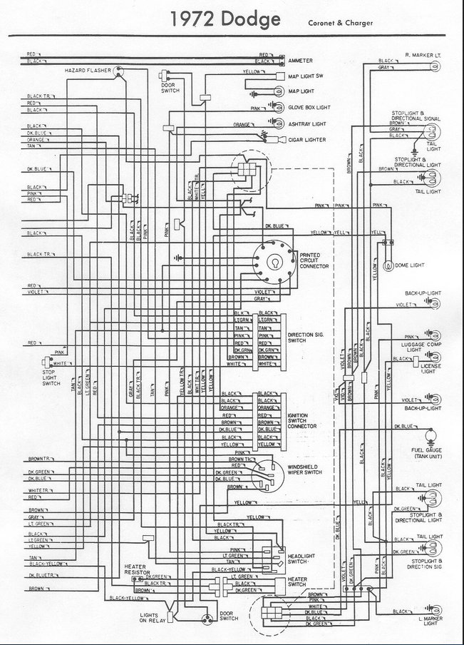

I don't have a chiltons but I was able to find this a while back, it's not 100% the same but it 98% the same.
Friday, September 20th, 2019 AT 2:42 AM

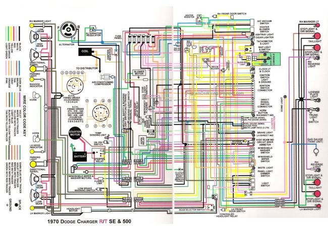

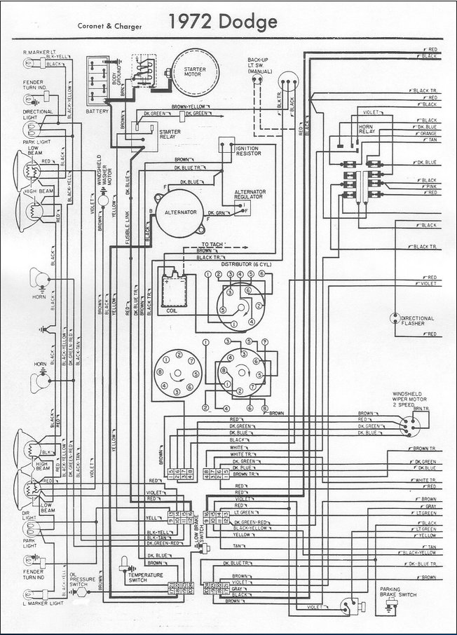

Okay, so I can't read the diagram you posted. Too small and fuzzy so I went looking and found this link...
http://www.mymopar.com/72to76_wiring.htm
In there I found the 2 diagrams uploaded below.
Praise the lord things have changed since then. These things are a nightmare. I had to study them for 30 mins just to get a grip and I still don't get it all.
Anyway, near as I can see, as I said the brake circuit comes out of the turn signal switch.
So, you say you have 12v going into the brown wire in the plug which I assume is the one on the bottom right of diagram "B" that I uploaded.
But you say you have nothing coming out of that plug. When you tested it did you unplug it or was it still plugged in when you got the 12v?
