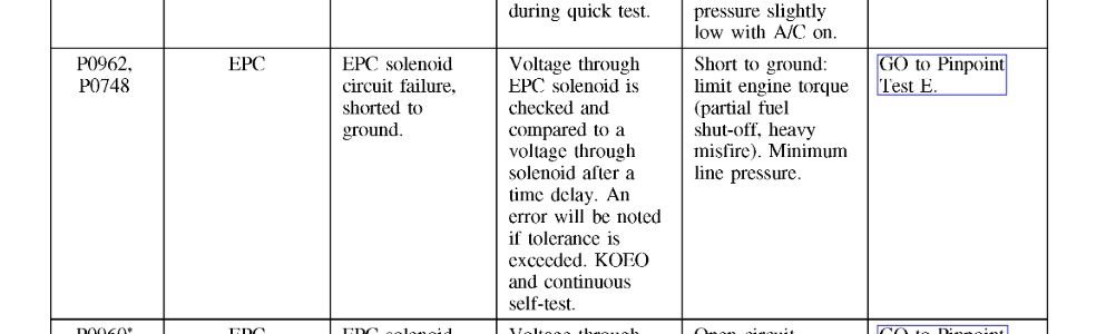

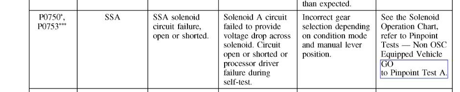

Got a shift solenoid code replaced it and it bangs in third and goes slow. what could be the issue?
Jun 2, 2019 at 5:15 PM
What was the code number?
Jun 2, 2019 at 10:23 PM
NOT PERFECT
  • 16 POSTS
P0748 and p0750.
Jun 3, 2019 at 7:08 AM
Got it.
These codes are electrical codes related to the wiring harness inside the transmission.
