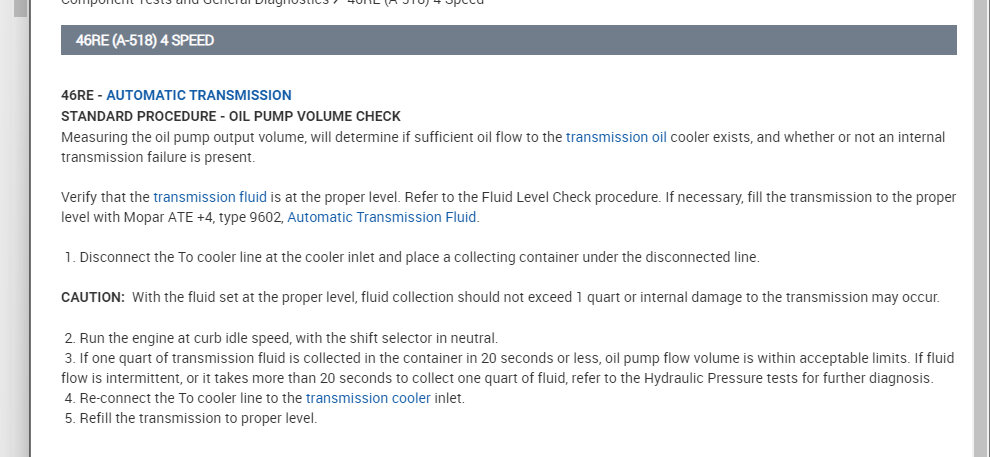

Truck listed above is a 2500 Gas 360ci 5.9 V8.
No 1st gear no overdrive and no passing gear.
I've replaced all sensor and Solenoid in the transmission.
i re-adjusted the front band.
replaced output sensor on the transmission.
reset the TPS.

This is normally a solenoid so since you have replaced all of them, we need to dig a little further. Normally we would do a pressure test but, on this transmission, they want us to do a flow test.
So, let's start by checking the fluid level and condition to make sure it is at the proper level. Here is a guide that will help with this:
https://www.2carpros.com/articles/how-to-check-and-add-transmission-fluid
Next thing is to check the volume using the info below. Basically, this is going to tell us if we have a pump issue or a possible internal issue.
Please run through this and let us know what you find. Thanks

Fluid is clean(new) filled to the full level on the dipstick.

Okay. Great. So that makes me think we have a pump issue or other internal issue that is causing low pressure which will result in these issues.
