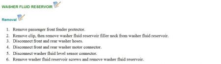

Can you please tell me if it is possible to change out the windshield washer tank by yourself without taking it to a dealer? I believe my washer reservoir is broke.

https://www.2carpros.com/forum/automotive_pictures/261618_Noname_2787.jpg
https://www.2carpros.com/forum/automotive_pictures/261618_Noname2_907.jpg
