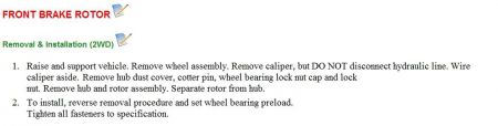

How do you go about removing the front brake rotors on this vehicle?
Wednesday, September 29th, 2010 AT 1:10 PM
BLUELIGHTNIN6
MECHANIC
16,542 POSTS
+1
Wednesday, September 29th, 2010 AT 1:21 PM
