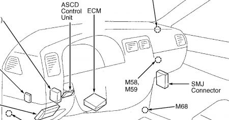

I recently got a Chilton and my check engine light is on. I was looking up information about why the light may be on. There is a reference to being able to determine the code by using a diagnostic tool on the PCM, but nowhere in the Chilton does it explain where this PCM is located. Can you tell me where I would find this thing? Thanks.

use an OBDII reader, if that wont communicate some Nissans in the early 2000's still used their proprietary connector located next to the fuse block
https://images.2carpros.com/forum/automotive_pictures/99387_ecm_nissan_1.jpg
