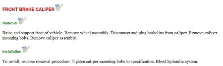

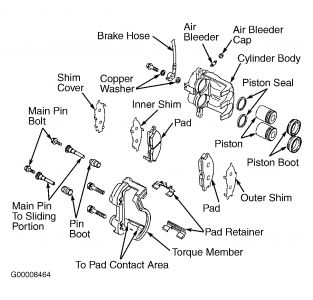

2000 Nissan Xterra 4 cyl Two Wheel Drive Manual 125K miles
How do I remove the front brake calipers?
