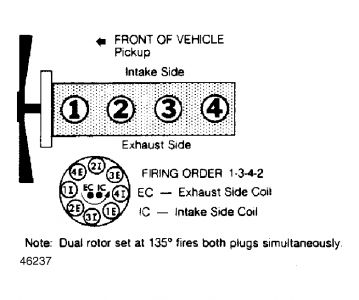

1985 Nissan X-Trail 4 cyl Two Wheel Drive
need to know the firing order of this 4 cylinder truck with 8 plugs
