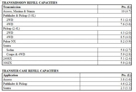

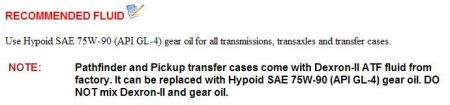

I need to know what type of transmission or gear oil I need for my truck.

SAE 75W90 ( API GL-4 ) gear oil
