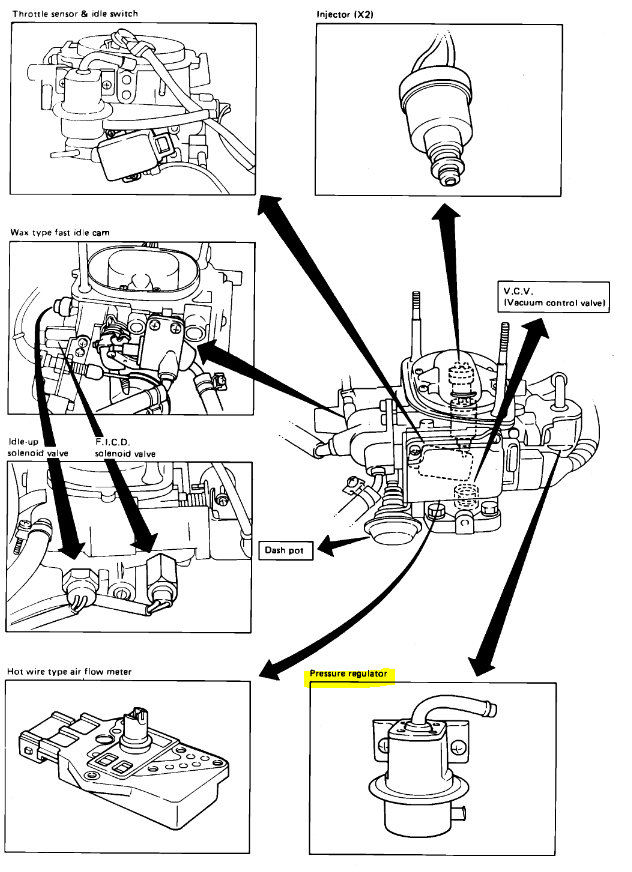

This issue could be due to a faulty fuel pressure regulator. The job of the fuel pressure regulator is to control the fuel flow and volume at a predetermined amount that was calibrated for the specific engine. A faulty regulator can allow too little or too much fuel and cause the engine to flood. Which will lead to poor idle or engine shutdown.

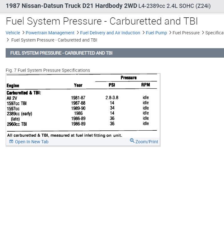

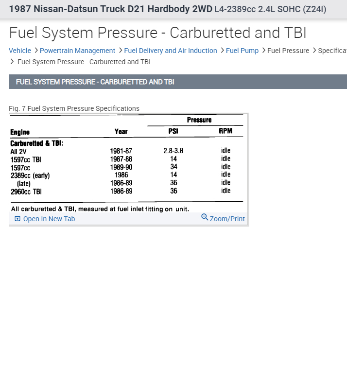

One of the ways this can be tested by checking the fuel pressure.
Here is a helpful guide on how to test the fuel pressure:
I have attached diagrams below for your reference.
