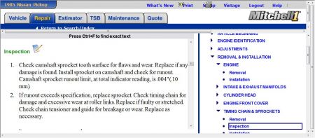

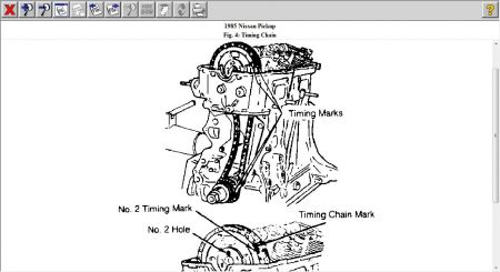

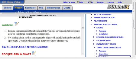

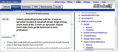

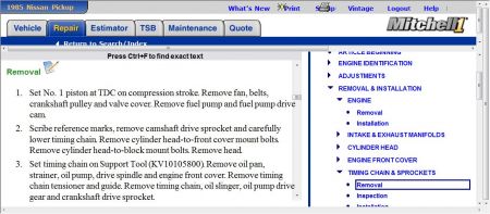

How do you repair the timing change on a 1985 Nissan King Cab truck?

See below
