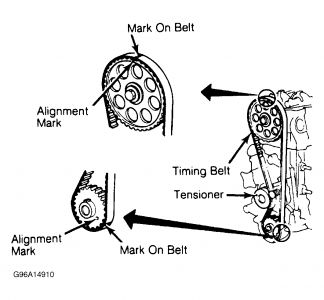

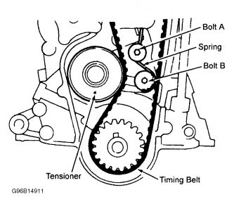

How do I line up crank and valve pulleys to time engine. Can't find any manuals for this 1988 stanza station wagon 4x4
Wednesday, November 3rd, 2010 AT 11:26 AM
DOCFIXIT
MECHANIC
18,828 POSTS
See diagrams
If 2.0L and belt broke will running most likely have bent valves
