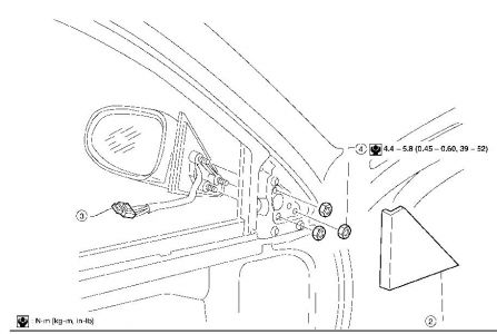

How to change my side mirror?
Sunday, February 8th, 2009 AT 1:19 PM
ZACKMAN
MECHANIC
4,202 POSTS
Open the door, use a flat screw driver to pop the triangular cover. Unplug wiring connector. Remove 3 nuts. Install is reversed.
