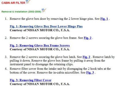

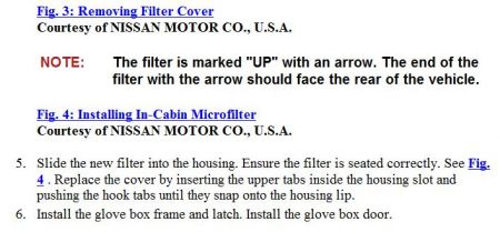

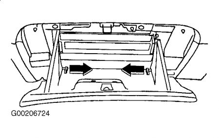

I was wondering if it was pretty easy to install the cabin filter for my nissan sentra 04. Anyone know instructions on how to?
Wednesday, March 11th, 2009 AT 6:47 PM
ZACKMAN
MECHANIC
4,202 POSTS
Thursday, March 12th, 2009 AT 2:20 AM
