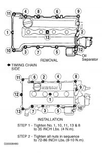

2002 Nissan Sentra need torque specs
2002 NISSAN SENTRA
LOVE2TEACH956
Transmission problem
2002 Nissan Sentra 4 cyl Manual 130000 miles
to replace my valve cover gasket. Can't find a manual in the library. Just need the torque specs and is there a tightening order for this one? thanks.

https://images.2carpros.com/forum/automotive_pictures/99387_Graphic_63.jpg
