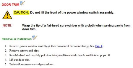

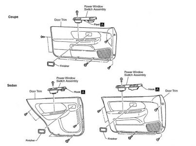

How do you remove the interior door panels to remove and replace side rear view mirrors?

FIG. 4
