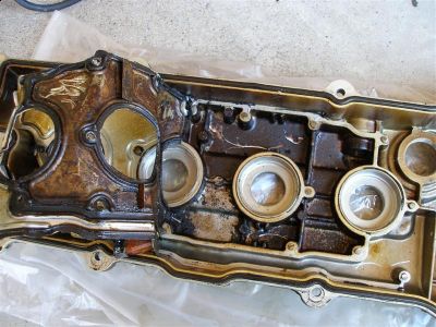

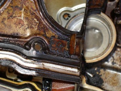

OK...finally fixed! I tried another PCV, PCV hose, re-installed the original PCV, etc. I finally (even though I couldn't see why) installed a different valve cover. I took a valve cover off of another sentra I have (for parts), installed a new gasket but left the old PCV valve in the cover...and installed it on my driver. No oil usage what-so-ever. I have no idea why this worked. The cover I took off was pristine inside. The one I installed had sludge all in it (I didn't clean it!). It has to have something active in the top of the cover underneath the riveted in windage tray. It must be related to the PCV system because I saw no other signs of oil consumption (No oil in the air filter, etc). Here are some pictures of the valve cover I took off.
https://www.2carpros.com/forum/automotive_pictures/338786_DSCN9951_1.jpg
https://www.2carpros.com/forum/automotive_pictures/338786_DSCN9952_1.jpg

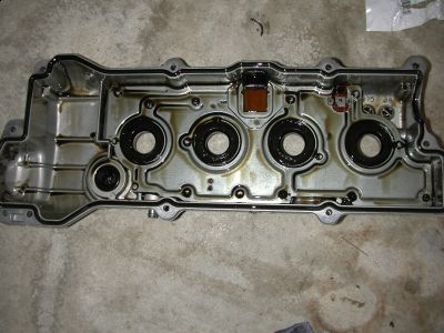

I just wanted to give an update in case anyone runs into this thread will searching. Just like befland, I replaced the valve cover. I didn't want to take the chance of picking one up at a junk yard and have it still smoke. I bought a new one from Nissan. Online of course, my local dealer wanted more than double what i paid for it online.
Replacing the valve cover stopped the oil use. The car is back to it's normal, no oil use. Almost 800 miles since, still right to the full line on the dipstick. The car also runs much smoother and no longer pings, just like before this started.

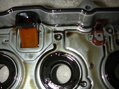

The valve cover looks just like the picture posted previously. I was curious what is above that metal plate so I pried it off partially. What I found underneath is basically nothing. It does not have any baffling or filtering material in that space. Both the PCV valve and the other vent off the cover go into this area above the plate. The plate has a RUBBER seal around it. That rubber seal is the only thing preventing oil from getting to the intake.
What happened with my car was when I replaced the valve cover gasket, some of the brake cleaner I used on one tough deposit must have run under that plate, onto the rubber seal. A day later, it had damaged the seal enough to allow oil to be drawn into the the sealed portion under the plate and up into the intake.
https://www.2carpros.com/forum/automotive_pictures/315551_P6050003_Medium_1.jpg
Closeup of the seal. Not necessarily where it was damaged though.
https://www.2carpros.com/forum/automotive_pictures/315551_P6050004_Medium_1.jpg
