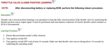

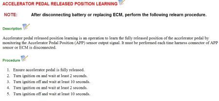

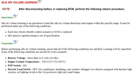

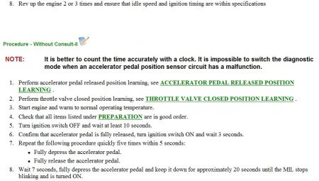

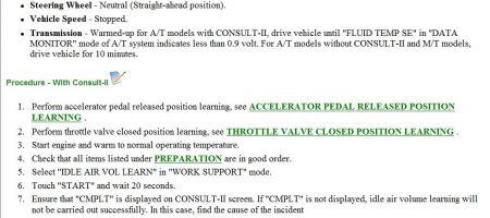

2004 Nissan Pathfinder how to do a relearn for the throttle
KEVIN_LB
MEMBER
2004 NISSAN PATHFINDER
Engine Mechanical problem
2004 Nissan Pathfinder 6 cyl Four Wheel Drive Automatic
how to do a pedal relearn, a throttle position relearn, and an idle air volume relearn
