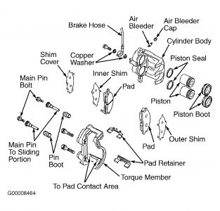

I looked at the video on changing brakes, but my pathfinder is very different. Can u help me?

Front pads need to hold Main Pin with wrench then unbolt Main pin bolt. Remove caliper and pads
see diagram
Hope this helps
