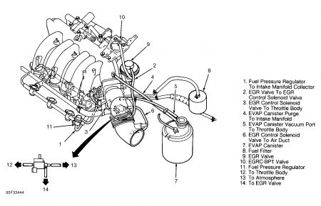

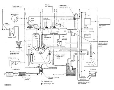

Need a vacuum hose routing sheet for 1995 Nissan Quest GXE (engine Compartment)
