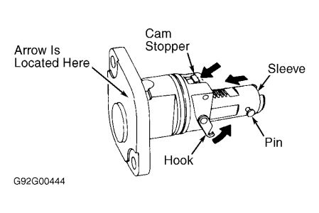

i had my head gasket replaced and now at start up sounds like my timing chain tensioner failing

Hi there,
With the rocker cove off, look down at the side of the timing chain (use a good torch) and see if the lock hook on the chain tensioner has been released, if not flick it off with a long screw driver, see pic for a close up view of the tensioner.

sorry, forgot to add the pic.
https://images.2carpros.com/forum/automotive_pictures/61395_Graphic_165.jpg
