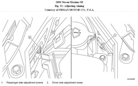

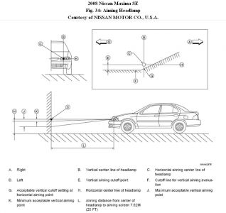

I have a problem I need to adjust my 08 maxima headlights how do I adjust them? Where is the screw to adjust them?

Hi 12bob,
Refer to diagram for screw location.
