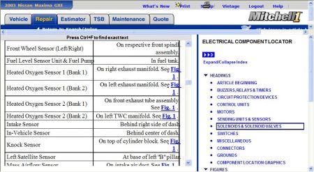

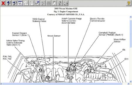

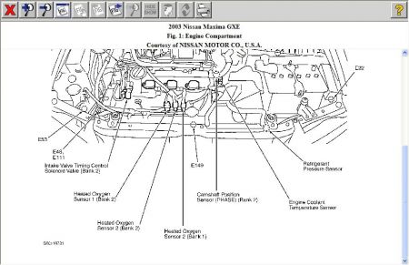

Can this be repaired, where is it located
Monday, December 1st, 2008 AT 7:47 PM
2 Replies
MECHANIC
75,992 POSTS
You got 4 of them-see below
Monday, December 1st, 2008 AT 8:03 PM
BMRFIXIT
MECHANIC
19,053 POSTS
You have 4 O2 sensors
located on exhaust system
before and after catalytic converters
I suggest replacing all 4
good luck
