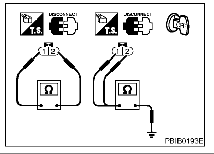

Our maxima has about 87000 miles has started clattering and the diagnostic indicated a ITC Valve the needs cleaning or replacement and, I think, cam shaft timing out of phase. How difficult is it to replace the ITC Vavle. I think that is the Intake Timing Control Valve.
Mark
Tuesday, August 10th, 2010 AT 10:22 PM
  • 75,992 POSTS
Intake Valve Timing Control Solenoid Valve (Bank 1)On top front of right cylinder head.
Intake Valve Timing Control Solenoid Valve (Bank 2)On top front of left cylinder head.
https://www.2carpros.com/forum/automotive_pictures/12900_itc_1.jpg
Component Inspection
INTAKE VALVE TIMING CONTROL SOLENOID VALVE

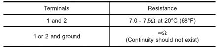

1.Disconnect intake valve timing control solenoid valve harness connector.
https://www.2carpros.com/forum/automotive_pictures/12900_itc1_1.gif
https://www.2carpros.com/forum/automotive_pictures/12900_itc2_1.jpg
2.Check resistance between intake valve timing control solenoid valve terminals as shown.
