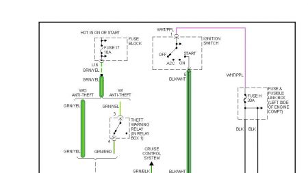

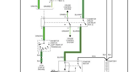

WHEN I TURN THE KEY IT CLICKS BUT NO FIRE. I CHARGED THE BETTERY AND TAPED THE STARTER NEITHER HELPED. ANY IDEAS
Tuesday, March 25th, 2008 AT 4:32 PM
MECHANIC
75,992 POSTS
Troubleshoot the starting system see below
