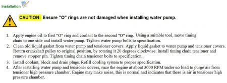

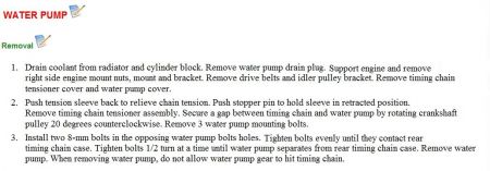

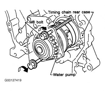

How do you change the water pump?

Wednesday, November 10th, 2010 AT 8:00 PM
