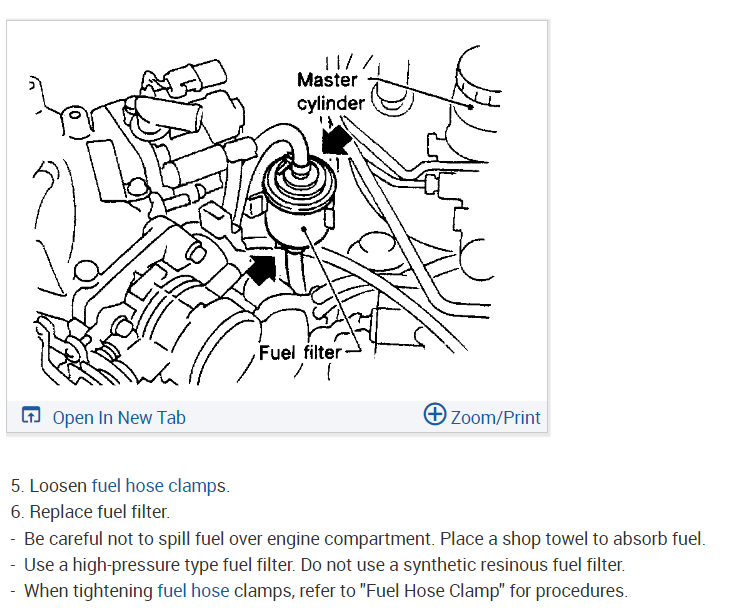

Dear Sirs: could you please notify me where the fuel filter is located on this vehicle?

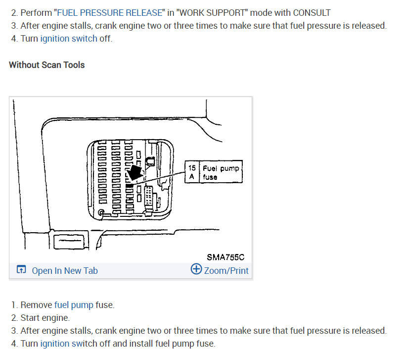

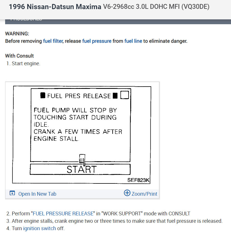

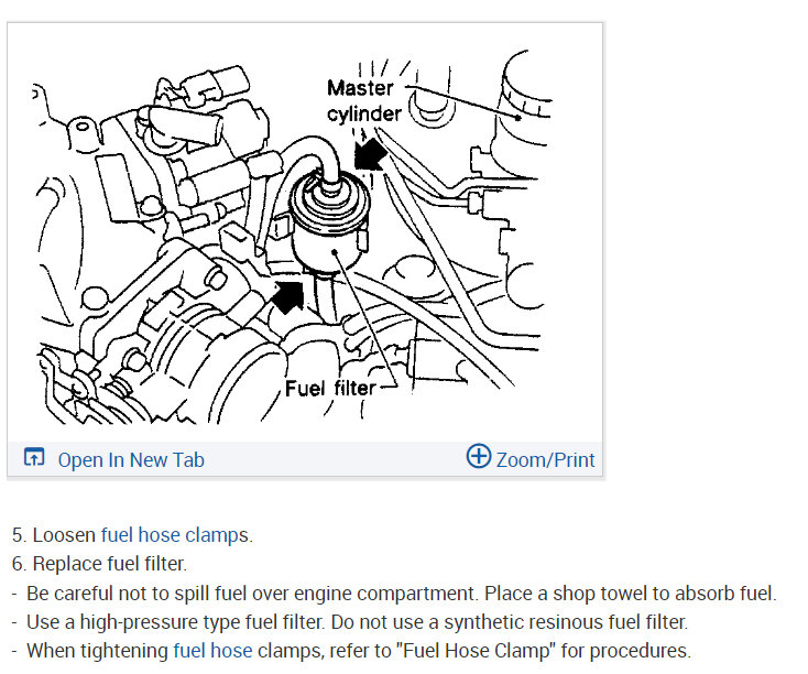

That is incorrect, the fuel filter is located by the brake master cylinder under the hood of the car, You should relieve the fuel pressure which I show how to do in the images below along with how to change the fuel filter out. Check out the images (below). Please let us know what happens.
