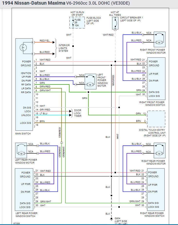

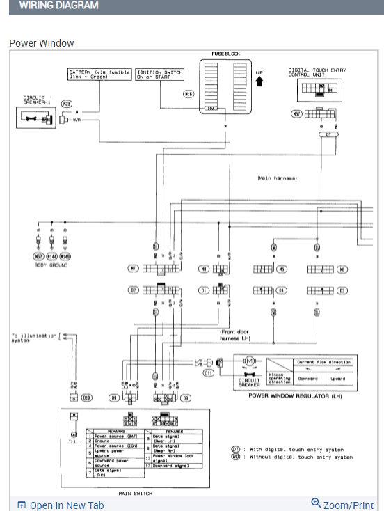

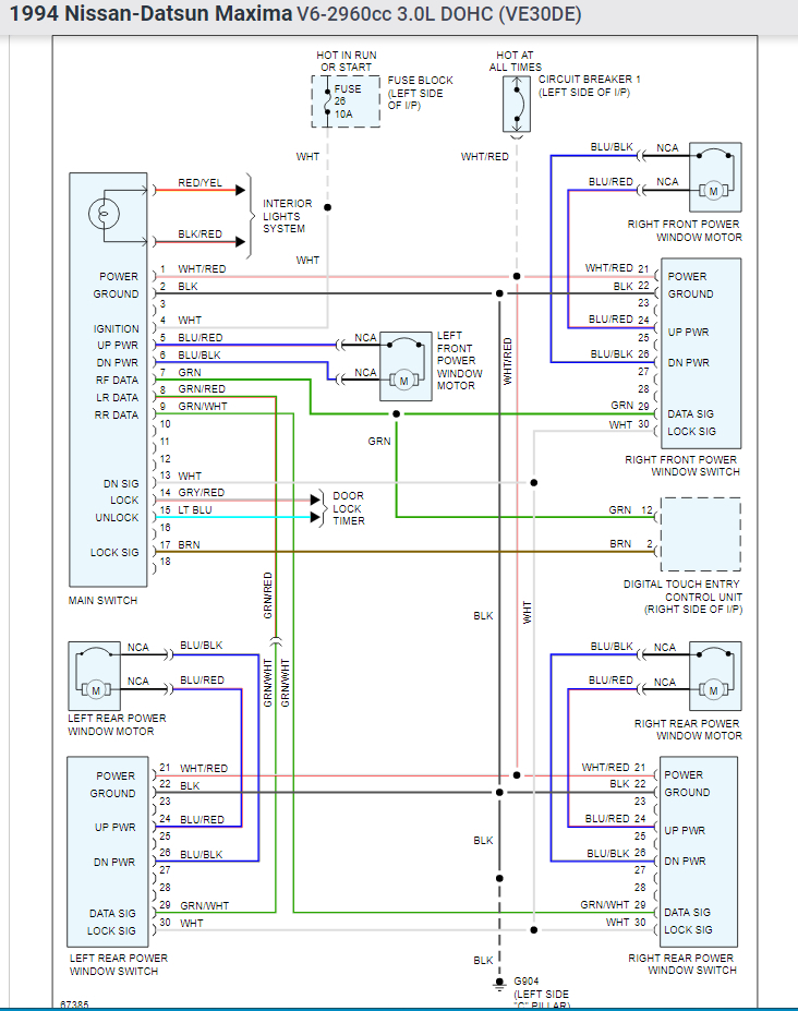

i have a 94 nissan maxima, the driver side switches don't work. the passenger side windows and the two back windows also don't work . My door locks work though, i checked my fuses and they look good, no burn or worn, i am not that mechanically inclined so what could the problem possible be? my motor my regulator manual doesn't help.

This sounds like you might have a issue with the power window master switch.
Do the windows work with their respective switches? Will the back window work from the switch on the back?
Here is a testing procedure for the window switch:
https://youtu.be/HBFBcJrdym4
