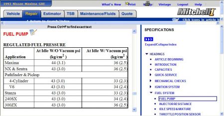

Thanks alot just got one more question do you know how much pessure is adequate for it to start?Whats the psi im lokking for?

Thanks alot just got one more question do you know how much pessure is adequate for it to start?Whats the psi im lokking for?[/Quote:675ad4a18d]srry and is there a tester they sell that will fit the hose coming into filter?

  • 75,992 POSTS
Yes you can buy it from us or check out the Good Stuff guys NAPA or any auto parts store
Fuel pressure specs see below and good luck my friend
https://www.2carpros.com/forum/automotive_pictures/12900_nissan_fuel_pressure_1.jpg
