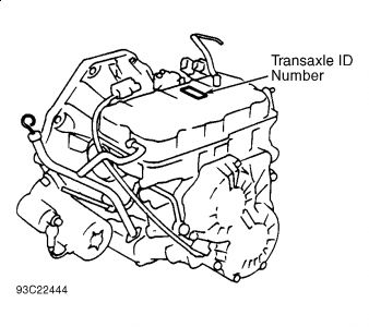

will I be able to replace a transmission out of a 92' nissan maxiam into a 91' maxima

According to Mitchell 1 there are 3 transmissions used in the Maxima for 91-2 check the trans ID No is identical with the unit you want to swap with.
see pic.
