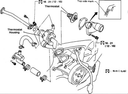

Were is the thermostat located the engine never over heats but when it gets hot antifreeze will blow out of the cap I think I have a vapor lock want to remove thermostat

Thermostat And Housing.
https://www.2carpros.com/forum/automotive_pictures/12900_t_23.jpg
https://www.2carpros.com/kpages/auto_repair_manuals_alldata.htm
