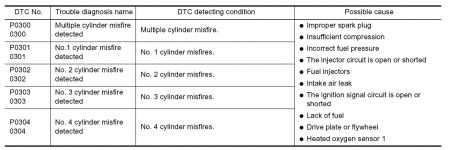

just hooked up a ACTRON CP-9175 and got a P0300. any suggestions? I hope the new CAT is not bad. Right now I'm going back to my repair manual to see what I missed during the TS phase. Any help would be appreciated
Dec 22, 2008 at 2:20 PM
IMPALASS
  • 3,112 POSTS
Hello - Well as you may know.... DTC P0300 MULTIPLE CYLINDER MISFIRE Now that could have happened before but may have also caused the cats to overheat....It received this info from the crankshaft sensor. I attached the pic
https://images.2carpros.com/forum/automotive_pictures/248015_1_125.jpg
As you can see from the other attached info on the misfire....it could be a number of things. Was the car running okay before you changed the 02's and the CATs? If so, it may be a older code. So you may go down the probably causes and check and verify. Did you ever talk to the dealer about the reprogram of the ECM and the TSB? On Board Diagnosis Logic When a misfire occurs, engine speed will fluctuate. If the engine speed fluctuates enough to cause the crankshaft position (CKP) sensor (POS) signal to vary, ECM can determine that a misfire is occurring. The misfire detection logic consists of the following two conditions. One Trip Detection Logic (Three Way Catalyst Damage) On the first trip that a misfire condition occurs that can damage the three way catalyst (TWC) due to overheating, the MIL will blink. When a misfire condition occurs, the ECM monitors the CKP sensor (POS) signal every 200 engine revolutions for a change. When the misfire condition decreases to a level that will not damage the TWC, the MIL will turn off. If another misfire condition occurs that can damage the TWC on a second trip, the MIL will blink. When the misfire condition decreases to a level that will not damage the TWC, the MIL will remain on. If another misfire condition occurs that can damage the TWC, the MIL will begin to blink again.

Come to think of it I did replace the Camshaft sensor a few months ago but never the Crankshaft sensor. The only reason I did that was because it would not start one day when my daughter was at work. Once I replaced it the car ran fine until recently. After doing more research, along with what you just sent me, I should have replaced both sensors. I guess I'll pull the other sensor and test it. However from all of the info that I've been reading this was also a problem with Nissan as well.

I replaced the Crankshaft sensor with the new and improved one and so far the car is running fine. reset the "SES" light and so far so good! Thanks for all of the help and have a Merry Christmas and Happy New Year.
