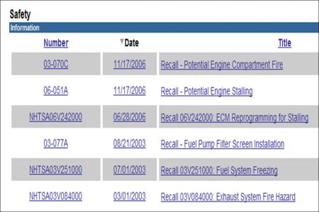

Thank you for that information. There are actually a couple of recalls on your vehicle dealing with the exhaust and as they put it; ". . .certain engine operating conditions may cause the pre-catalyst to overheat and damage the catalyst substrate."
Recalls as you know should be repaired for free.
My suggestion for you. One, if you wanted, you could use the loan/tool program that AZ offers and bring the scanner home, check codes yourself. It would be interesting to see if the car has thrown codes.
Next, I have attached the recalls. I would definite contact the dealer and set this up and hopefully they pay for all of it (programming).
Also, I found some other safety recalls you can ask them about. I just did a print screen so you will see the exhaust ones there and below.
I suggest you at least ask, since you were not aware of the recall and your cats were damaged would they be willing to reimburse you some or all of that cost. The worst that can happen is they say no.
Good on CATO for letting you know the information.
NHTSA03V084000 03/01/2003 Recall 03V084000: Exhaust System Fire Hazard
DEFECT: On certain passenger vehicles equipped with 2.5-liter engines, the exhaust pipe hanger pin may catch debris from the road that could be ignited by contact with the main catalyst.
REMEDY: Dealers will remove the protruding portion of the exhaust pipe hanger pin. In addition to the corrective action, in order to reduce the risk of fire in the event of poor or improper maintenance that could result in oil spillage, heat shield(s) will be installed on the pre-catalyst and exhaust tube. Also on 2002 Altima and Sentra vehicles, certain engine operating conditions may cause the pre-catalyst to overheat and damage the catalyst substrate. If substrate particles enter the combustion chamber, they could score the cylinder walls, resulting in increased oil consumption. If the engine oil level is not checked on a periodic basis and drops below the low level, and the driver continues to operate the vehicle ignoring noticeable engine noise, engine damage may occur that could result in a fire. Nissan is developing a remedy for the pre-catalyst problem. The manufacturer has reported that owner notification is expected to begin during May 2003. Owners may contact Nissan at 1-800-647-7261.
A second one to have them look at.
03-070C 11/17/2006 Recall - Potential Engine Compartment Fire
Another Recall to check on
05-114B 03/24/2006 Campaign - Rear Suspension Member, Bushing Replacement
https://www.2carpros.com/forum/automotive_pictures/248015_Picture6_15.jpg
Thursday, December 18th, 2008 AT 7:07 PM

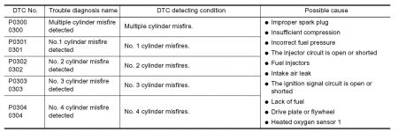

just hooked up a ACTRON CP-9175 and got a P0300. Any suggestions? I hope the new CAT is not bad. Right now I'm going back to my repair manual to see what I missed during the TS phase. Any help would be appreciated
Monday, December 22nd, 2008 AT 2:20 PM
IMPALASS
  • 3,112 POSTS
Hello -
Well as you may know. . .. DTC P0300 MULTIPLE CYLINDER MISFIRE
Now that could have happened before but may have also caused the cats to overheat. . ..It received this info from the crankshaft sensor. I attached the pic
https://www.2carpros.com/forum/automotive_pictures/248015_1_125.jpg
As you can see from the other attached info on the misfire. . ..it could be a number of things. Was the car running okay before you changed the 02's and the CATs? If so, it may be a older code.
So you may go down the probably causes and check and verify.
Did you ever talk to the dealer about the reprogram of the ECM and the TSB?
On Board Diagnosis Logic
When a misfire occurs, engine speed will fluctuate. If the engine speed fluctuates enough to cause the crankshaft position (CKP) sensor (POS) signal to vary, ECM can determine that a misfire is occurring.
The misfire detection logic consists of the following two conditions.
One Trip Detection Logic (Three Way Catalyst Damage) On the first trip that a misfire condition occurs that can damage the three way catalyst (TWC) due to overheating, the MIL will blink. When a misfire condition occurs, the ECM monitors the CKP sensor (POS) signal every 200 engine revolutions for a change. When the misfire condition decreases to a level that will not damage the TWC, the MIL will turn off. If another misfire condition occurs that can damage the TWC on a second trip, the MIL will blink. When the misfire condition decreases to a level that will not damage the TWC, the MIL will remain on. If another misfire condition occurs that can damage the TWC, the MIL will begin to blink again.
https://www.2carpros.com/forum/automotive_pictures/248015_2_82.jpg
Two Trip Detection Logic (Exhaust quality deterioration) For misfire conditions that will not damage the TWC (but will affect vehicle emissions), the MIL will only light when the misfire is detected on a second trip. During this condition, the ECM monitors the CKP sensor signal every 1,000 engine revolutions . A misfire malfunction can be detected on any one cylinder or on multiple cylinders.
