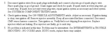

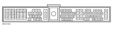

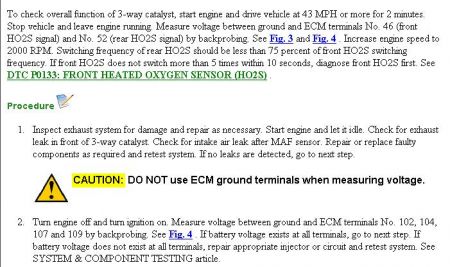

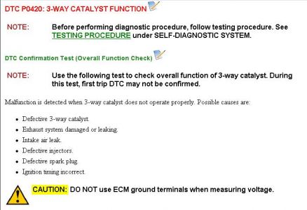

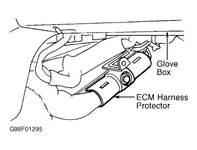

2001 Nissan Altima code0420
JENNIWOOD2
  • 2001 NISSAN ALTIMA
  • 4 CYL
  • FWD
  • 122,000 MILES
What does this code mean?
