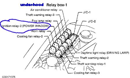

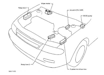

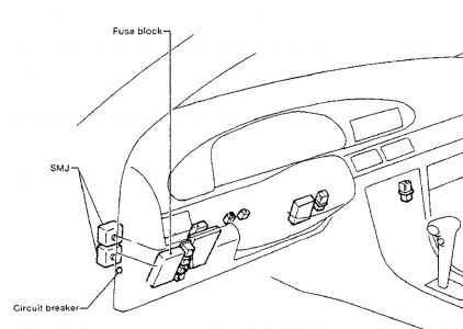

What would cause all four windows in an Altima to not work? We tried replacing the main switch on driver's door, but that did not help. Is there a fuse to check? Is so, where is it located?
Tuesday, January 8th, 2008 AT 8:05 AM
SERVICE WRITER
MECHANIC
9,123 POSTS
I did not see a fuse on this, only the 2 relays.
