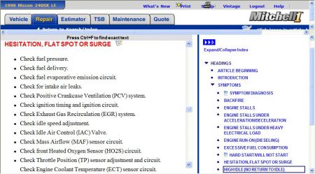

I have a 94 240sx (ka24de). My problem is that when I floor it, it wants to hesitate and not go anywhere. It also will not tach over 4,000 rpm. I replaced the plugs, rotor button, and distributor cap but that didn't really help it. Also when it is idling it will die off and idle rought sometimes.

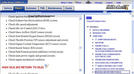

Below is your probable causes:
https://images.2carpros.com/forum/automotive_pictures/12900_s1_11.jpg
https://images.2carpros.com/forum/automotive_pictures/12900_s2_10.jpg

I can't really read that.

This is the best I could do-I go further you won't see it. Sorry
