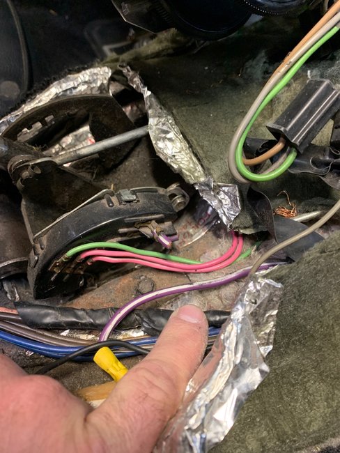

MICNMO93
  • 6 POSTS
I'm trying to put my nss back in. I have no idea what wire goes to what. Please any help would be great.

DANNY L
  • 5,648 POSTS
Hell, I'm Danny.
Unfortunately you've attached your response to a question that is years old. You will need to start a new question and be sure to include all your vehicle information.
Here is the link:
Thanks for using 2CarPros and hope to hear back from you soon.
