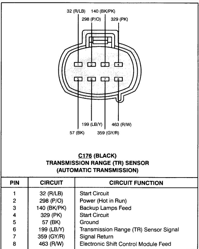

Wiring diagram 8 plug to 12 plug from 2000 Ford ranger

Here is the pin outs for the plug for the neutral safety switch. Check out the images (below). Let us know if you need anything else.

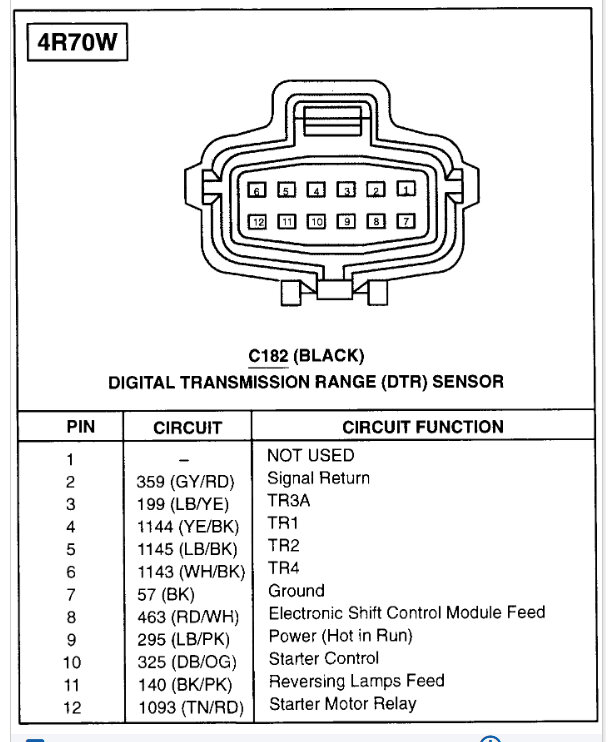

Can you give me a diagram for a 12 plug transmission range sensor for a Ford expedition 2000? Thank you

Sure, here you go, let me know if you need anything else.
