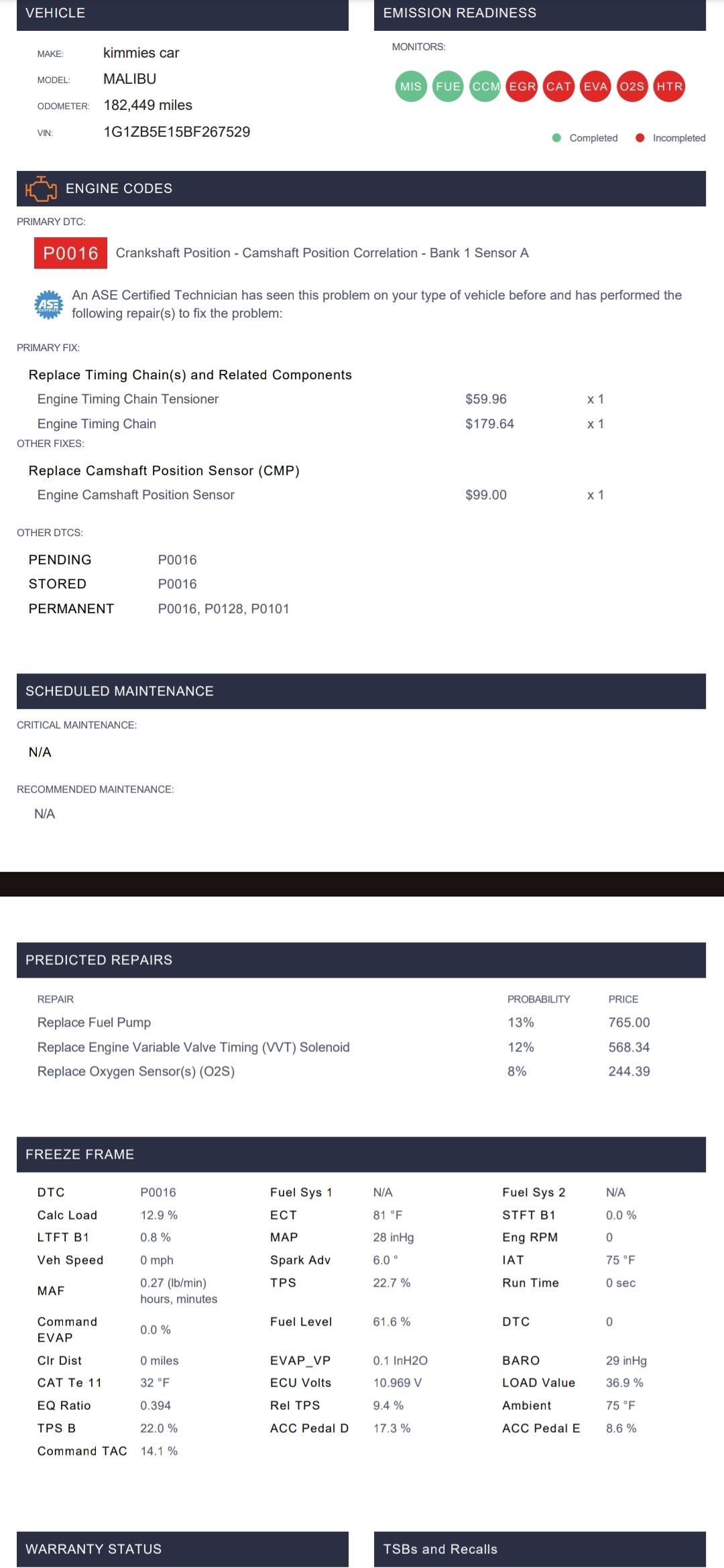

I first had camshaft sensor bank codes so I had replaced the intake and the exhaust camshaft sensors and ran good for a day or so then I get "Crankshaft Position Camshaft Position Correlation - Bank 1 Sensor A" I am looking for the testing specs for crank sensor and I would also like find the official relearn sequence for cam sensors and even crank shaft

This is the first reading and problem occurred

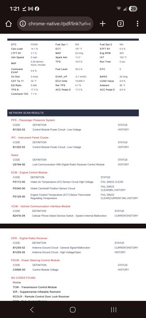

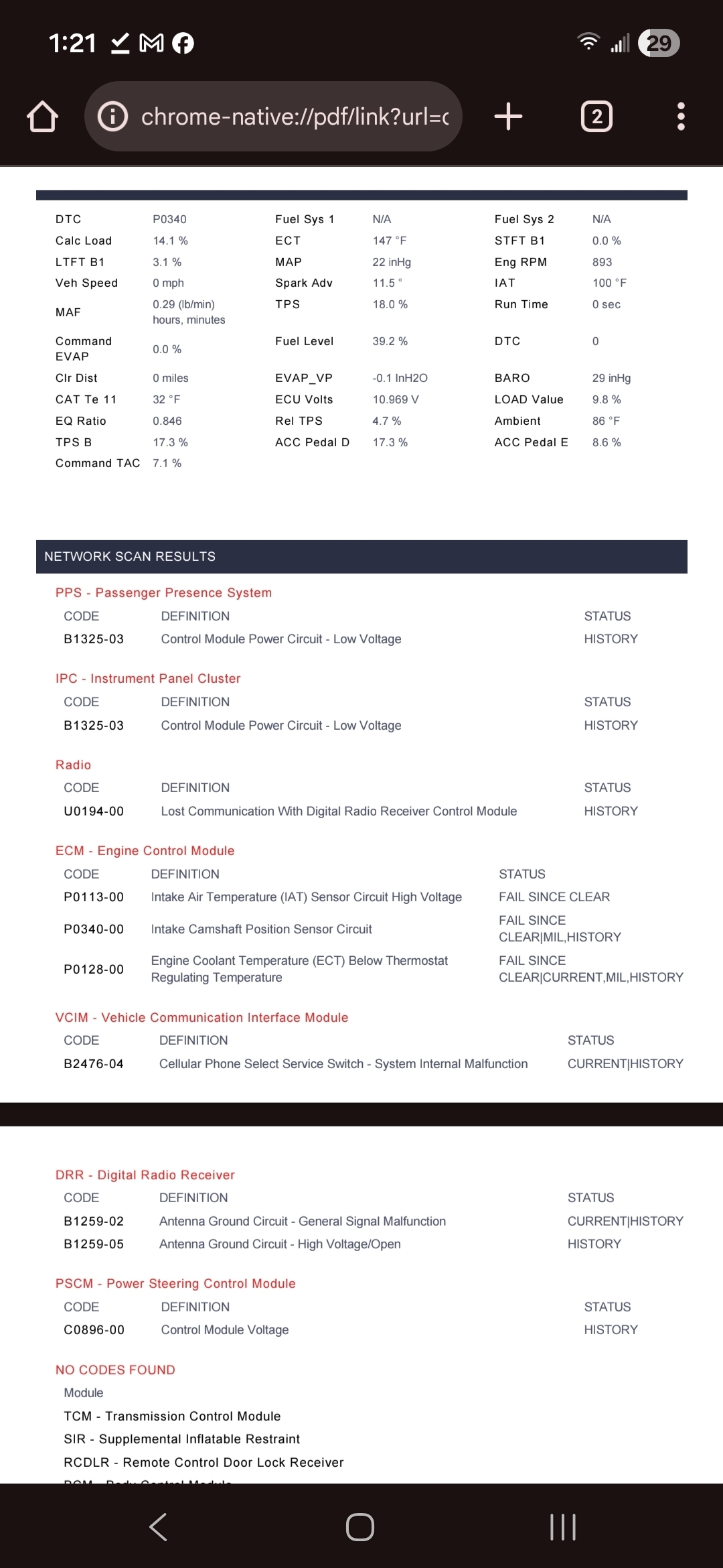

It was raining that day..the air filter was partially wet so so I got the map cleaner and new filter and ran ok clear the codes and took it for a test drive Within half a mile lost power DLC flash reduced engine power read the codes again

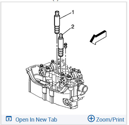

Yep, this problem happens when the timing chain, camshaft actuators, guides are worn out, but these codes can be triggered by low or dirty engine oil so make sure the oil and filter are clean and a new filter. What is happening is the camshaft is not in the position is needs to be compared to the crankshaft due to a mechanical problem not a sensor issue. If the engine makes a rattling sound at idle you know this will be the problem. If the engine oil is good you should remove the camshaft oil control valve to see if the screen on the end is clogged, here is the location so you can check it out. Remove both of them for inspection. Check out the images (below). Please upload an image or a short video in your response of the engine idling, so we can hear what's going on.
