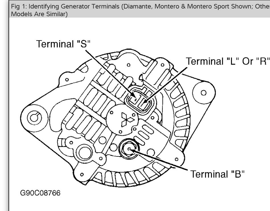

My car was in accident were it rear ended another car and crushed the front end, the alternator was damaged and replaced, but the connector from wiring harness was broken and I need to know which wire goes where. there is a red wire with white stripe and a white wire and I need to know how they would have been located in the plug.

look on connector or alternator for markings. b stands for battery and s is for starter. see picture.

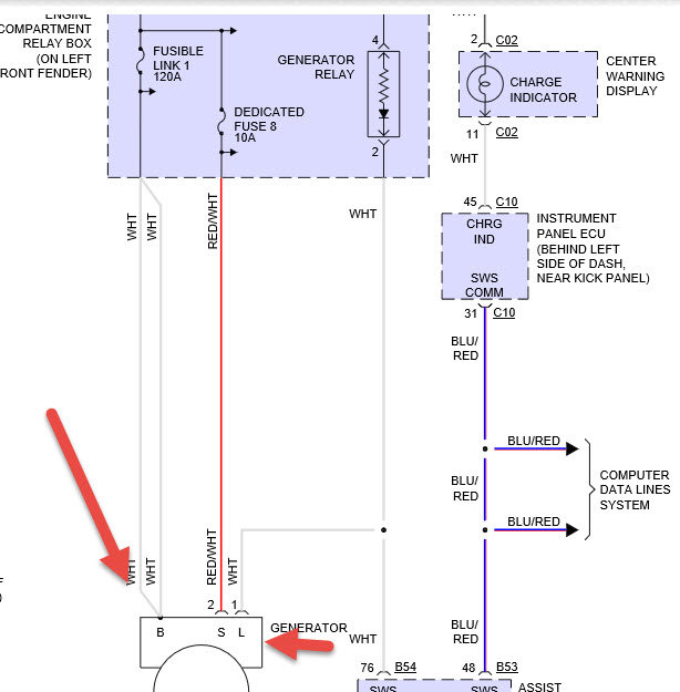

Hi,thank you, my alternator doesn't have the l and s markings on it/ I will need to know the location of the wires in the connector using the locking tab as a reference point as in from back side of conn. locking tab on right the red and white wire on top etc. if you follow me. the Mitsubishi alternator has no markings on it and I cant tell from the drawing the proper location of the wires in the connector

check your plastic connector it may be marked 1 & 2 so go by that. see pic that may help
