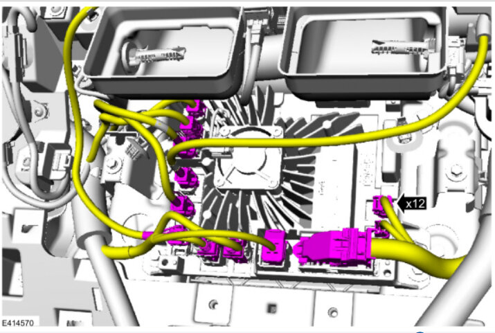

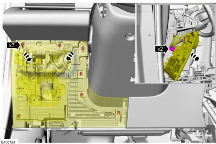

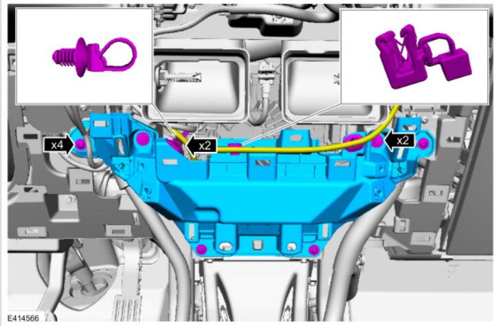

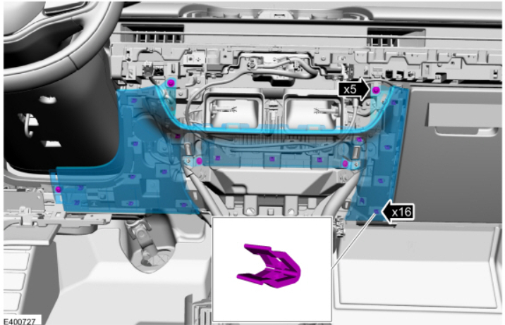

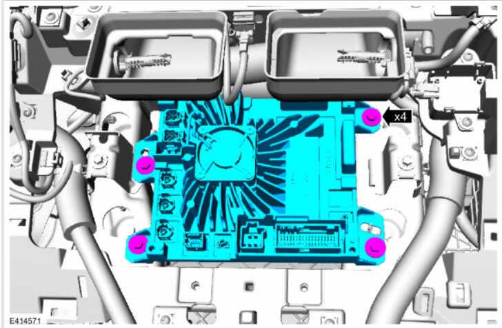

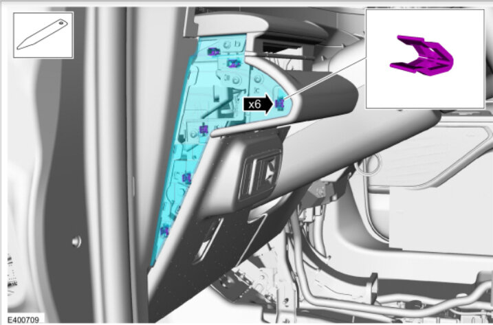

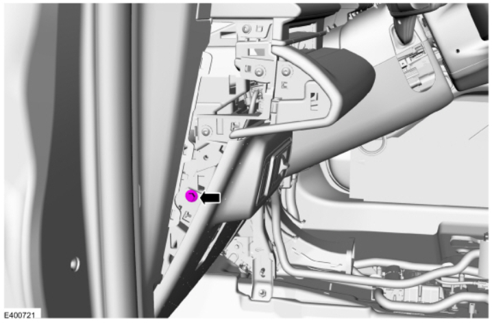

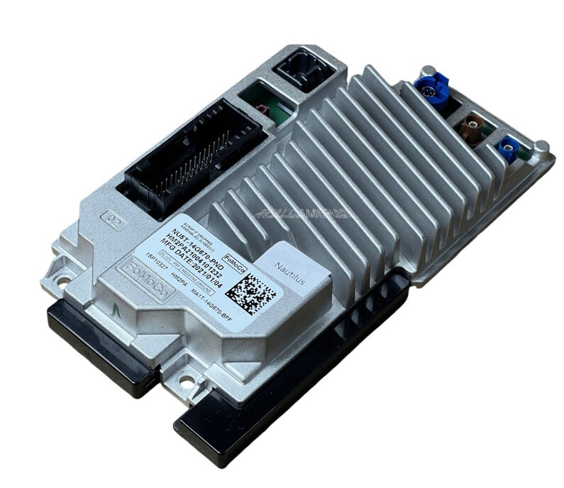

Need to know where the Sync 4 APIM module is located in 2024- 25 Lincoln Nautilus, and possible break down instructions for removal.
It didn't have the Nautilus model listed on the choices in the selection menu..
Aug 18, 2025 at 11:20 AM
  • 54,494 POSTS
The Sync 4 APIM module is situated behind the 8-inch center touchscreen display, typically positioned above or behind the HVAC control panel and radio units in the center dash assembly. Here is what it looks like and how to remove it, also it will need to be programmed, disconnect the battery before you begin. I added "Nautilus" to the selection on the site. Check out the images (below). Let us know if you need anything else.
