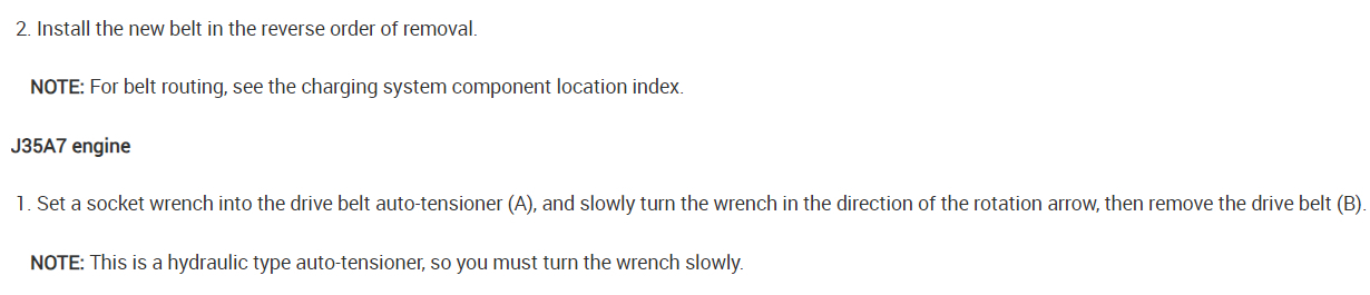

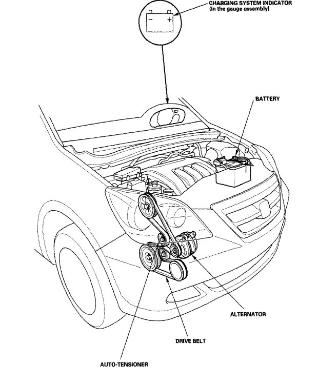

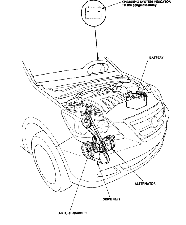

I need the correct diagram of the belt and exact location of bolt to release tension.

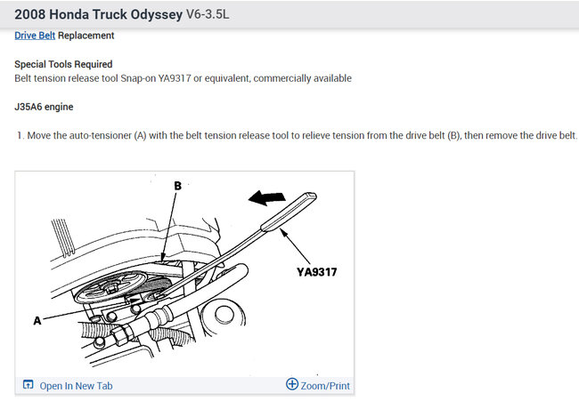

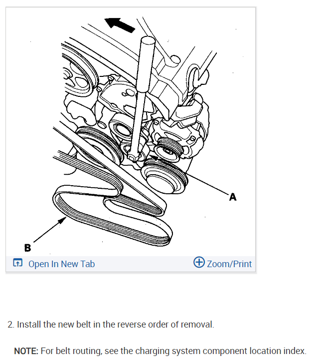

Sure, here are the instructions on how to replace the serpentine drive belt on your vehicle with the belt routing as well. Check out the images (below). Let us know if you need anything else.

Where is the location of the bolt to release stress of belt? Is it in the center of the tension wheel?

It is in the center of the tensioner pulley.
