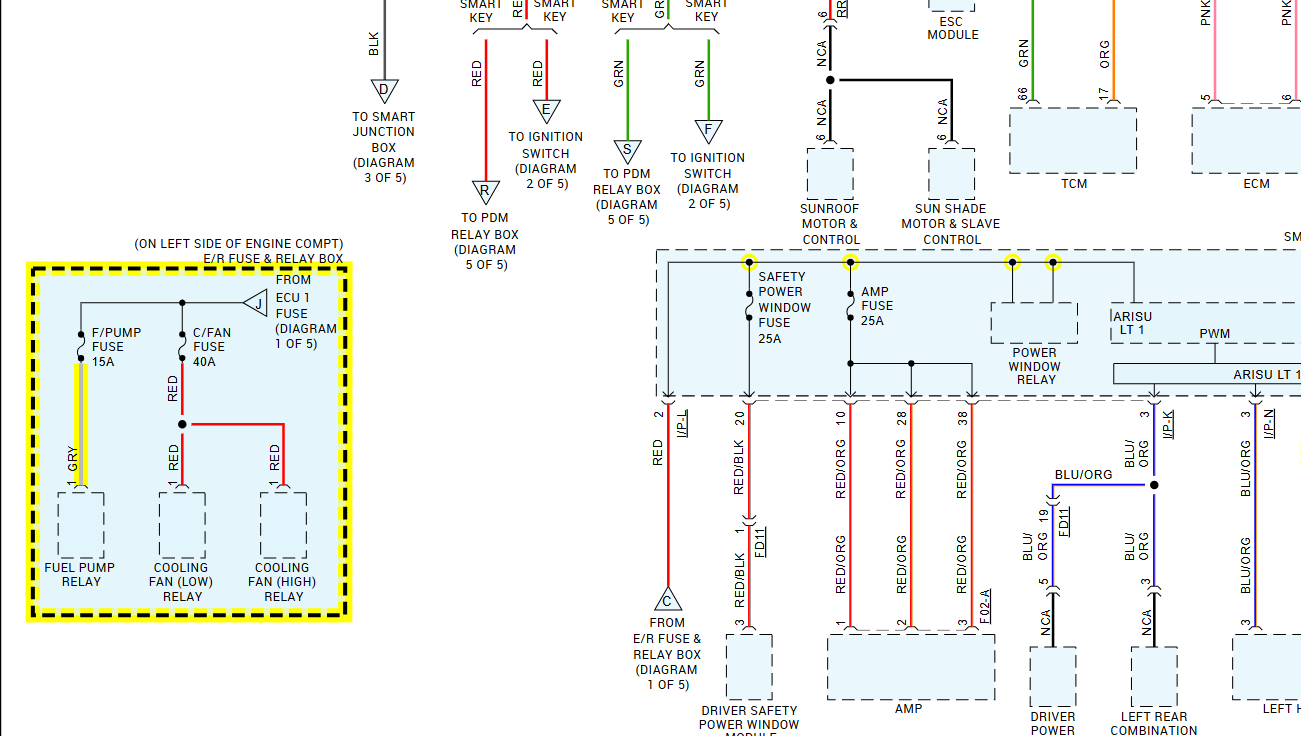

Can you change the scan tool setting also so the FRP is reading in psi and not kPa? But really you need to monitor that 4210kPa data PID, if it does drop off with the key On, engine Off, then it may not be an injector, check that first. And if you're changing GDI injectors make sure you pull the fuel pump relay for the pump in the gas tank and relieve the pressure first before cracking the high-pressure lines open. There's 1000s of pounds of pressure there, and you can get hurt very easily.

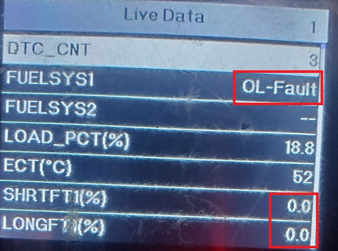

So, the MAP is no longer setting any codes? Or you haven't gotten to that yet? It's difficult with a MAP reading in kPa, instead of either psi or inHg. But I believe a MAP should read around 27 kPa at idle if I have that correct. But that will also vary depending on where you live, higher or lower than sea level, since the MAP reads absolute pressure. The Fuel Rail Pressure test is a good test when dealing with GDI systems, since you can't just tap into the fuel rail like a conventional system and do an injector leak down test, you probably could with a more advanced scan tool, but not a basic global OBD2 one. The PCM may have stopped reading data from the MAP since it was so far off, but the Fuel System status should go to CL Closed Loop now when it gets to operating temperature, and that OL Fault should disappear.

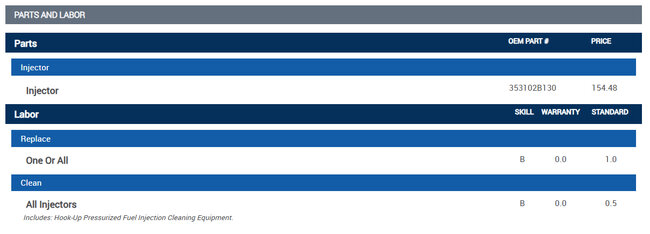

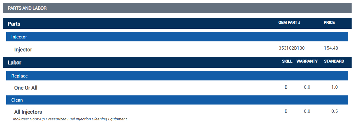

I'd be curious to see how it runs with the MAP sensor unplugged. Since I don't see a MAF sensor, some systems will default to known good data when some components fail like this. I don't know if it would do that for a sensor or not, sometimes on GM vehicles it will for failed modules. Here's the OEM injector part number if needed. How is the #2 coil doing, not over heating at all?

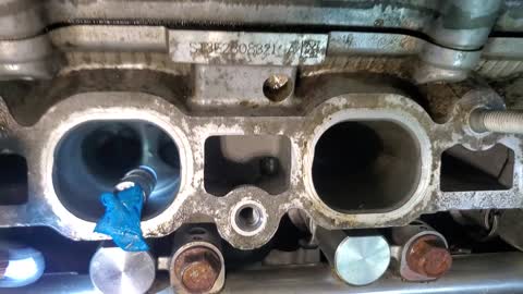

Unfortunately, I do not have that tool however I was looking in the valves and is it normal for one to be down a little bit and the other three to be all the way up here's a little video.
Saturday, May 18th, 2024 AT 1:30 PM
ANN SENN
  • 49 POSTS
Well, I'm trying to send the video and it won't upload.
Saturday, May 18th, 2024 AT 1:34 PM
AL514
  • 5,584 POSTS
No that's not normal, with 2 intake valves and 2 exhaust valves, each pair should be the same. Are you taking a video with the valve cover off?
Saturday, May 18th, 2024 AT 3:02 PM
AL514
  • 5,584 POSTS
If the valve cover is off, you can take a look at the valve springs and see if one is broken, take a picture if you can't upload a video. Is it the #4 that you see a valve hanging open?
The valves are adjustable on this engine, but it's with tappets that sit under the camshaft lobes, and wouldn't cause the valve to be open enough to visually see it.
Saturday, May 18th, 2024 AT 3:07 PM
ANN SENN
  • 49 POSTS
Intake manifold off cylinder 2 is about.25"
Below flush. Where the others are.
Saturday, May 18th, 2024 AT 7:42 PM
ANN SENN
  • 49 POSTS
AL514
  • 5,584 POSTS
It's difficult to see in the video, but I'll take your word for it, did you pull the valve cover off and inspect the valve train for any issues? They're very clean for being a GDI system, usually there's a ton of carbon build up on the valves and it requires a walnut blasting to clean them out. But I would start by checking under the valve cover to see if there's anything you can spot visually. Thats definitely going to be the cause of the #2 misfire code. Obviously if you find a broken valve spring, it will have to be replaced. When you have the valve cover off rotate the engine by hand and watch the #2's valve/camshaft movements. But you have a very good idea of what you're doing, I'm sure you can get this figured out. Let me know if you need any further service info.
